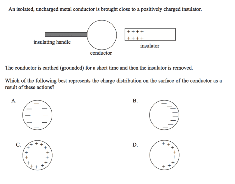

I chose B because I thought the positive charges in the insulator would attract the negative charges in the conductor to one side. I do realize that it is earthed for a short time. What difference does it make?
Thank you
What happens when "the insulator is removed"?
The negative charges redistribute themselves evenly around the conductor?
Yes
mjc123 said:
Yes
Oh~so 'earthing' has the same effect as removing the insulator?
No. Earthing allows the (previously isolated) conductor to acquire a negative charge as a result of attraction from the positively charged insulator. Then the Earth is disconnected (the question doesn't say this explicitly, but it is implied in "earthed for a short time") and then the insulator is removed, and the negative charge is redistributed.
okay, so if the insulator was not removed, the answer would have been B?
Yes
mjc123 said:
Yes
Thank you so much!
