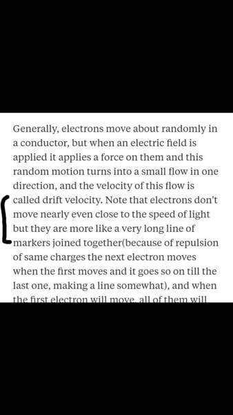

Electrons move slowly which is drift velocity.
Does these slowly moving electrons enter Earth when a circuit is connected to earth?
On quora it says that they move in line. So the electrons must enter the Earth one by one as when grounded, current is still flowing which means electrons are moving with drift velocity
So will this effect the circuit after electrons hve moved in the ground?
They will only move to ground if the other part of the source is also connected to ground ... there needs to be a complete path ( circuit)
eg. if you just take a wire from the negative terminal of a battery and poke it into the ground ... no current will flow as the circuit isn't complete
