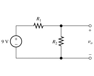

Design a voltage divider circuit to provide an output voltage v0 = 5V from a 12V source. The current taken from the 12V source is to be 100mA.
a)Find the values of R1 and R2.

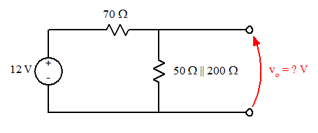

b)Now suppose a load resistance of 200 ohms is connected across the output terminals (in parallel with R2). Find the value of v0.

I would assume that I would use the above equation V1 = VR1/(R1+R2), but I am stuck on what to do next.
The picture above was taken from online, but the voltages written in the question are the correct voltages to be used. Disregard the voltage given in the picture
If the current taken from the 12 V source is 100 mA, how much current flows through ##R_1##?
Is it 100 mA because it is in series, so current is constant?
Yes. How many volts does ##R_1## have to drop from 12 V in order for there to be 5 V at the output?
Likes Adeel Ahmad
That would be 7V, so R1 = V/I = 7V/.1A = 70 ohms?
That's right. Handle ##R_2## in the same manner.
Likes Adeel Ahmad
So for R2, V = 5V since voltage needs to add up when in series. Therefore, R2 = V/I = 5V/.1A = 50 ohms?
Sure. Check your results using the Relevant equation that you gave in your first post. Make sure you use the right resistance values in the right places in that equation!

No, you should combine the new resistance with the ##R_2## first, then apply the voltage divider equation to the new circuit.
Adding the additional load to the original voltage divider circuit will change the amount of current being drawn from the 12 V source, so the drop across ##R_1## must change; The 5 V you calculated previously for the output of the divider no longer holds.
So what voltage would I use in the voltage divider equation? Would it be the original 12 V?
Yes. The source hasn't changed.
Edit: You're new circuit looks like this:
Using that then, I do V = (12V)(40 ohms) / (70 ohms + 40 ohms) = 4.36 V and that doesn't appear right
And yet it is!
