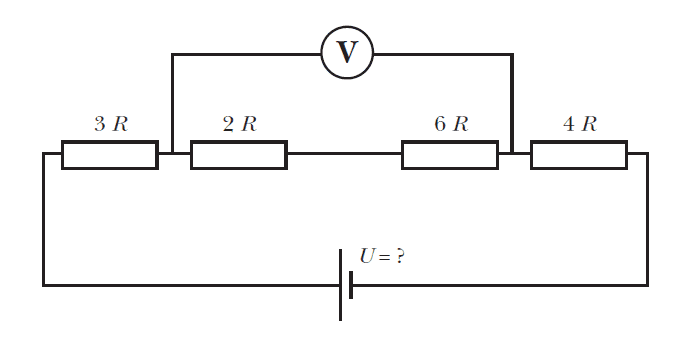

Electricity: voltage calculation in serial
In summary, the voltmeter gives a value of 150V. The Attempt at a Solution found that if I have only one equation, I can try to create a system of linear equations.
Epoch
24
Calculate the voltage U.
The voltmeter gives a value of 80V.
[/B]
3RI + 4RI - U = -80
How can I create a System of Linear equations if I have only one equation?
Do I miss something?
My answer sheet says U = 150V.
What is 'R'? Is it a variable, or does it represent "resistor"? I guess it really doesn't matter. If it is a variable, the R's should cancel out. You know that the voltage across the 2 inside resistors is 80 V, so you should be able to come up with a second equation for that.
[/B]
3RI + 4RI - U = -80
Let I be the current through the circuit. The V to the drop at 2R and 6R, so
2RI + 6RI = 80
8RI = 80
RI = 10
For the whole circuit,
U - 3RI - 2RI - 6RI - 4RI = 0
Try to take it from there!

Thanks, I got it.
2RI + 6RI = 80
8RI = 80
RI = 10
RI = 10
U - 3*10 - 2*10 - 6*10 - 4*10 = 0
U - 30 - 20 - 60 - 40 = 0
U - 150 =0
U = 150V
I found it, thanks for your help.
