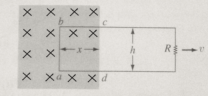

Situation: I have a B-field and I'm pulling a straight piece of wire through that B-field
You pull the wire perpendicularly through the B-field at velocity v; charges between points a and b will experience the Lorentz Force and will begin to move along the wire with velocity u, and thus will experience a force opposite to the direction which you are pulling the wire.
Goal: Trying to derive the work done on a unit charge the classical way (by integrating along the path it takes)
Let us define the force per unit q to pull the wire through the field: f(pull)[itex]\equiv[/itex]uB
$$\int f_{pull} \cdot dl = (uB) \frac{y}{cosθ}sinθ= vBhy$$
Problem: The vector f(pull) should be pointing outward (opposite the direction of wire pulling). so then shouldn't there be a negative sign somewhere?

I decided to try and derive it my own way and i ran into a problem somewhere but i can't seem to spot where it is.
I said that, there is a vertical work component and a horizontal work component.
(From the initial pull)
$$W_y= \int (q\vec{v} \times \vec{B}) \cdot dy = (qvB)y= qvBy$$
$$W_x= \int (q\vec{u} \times \vec{B}) \cdot dx = quBx =quBytanθ$$
vectorial sum
(yes i know work is a scalar quantity. but there is a work in x direction and work in the y direction so i thought i'd try this approach)
$$W= \sqrt{(qvBy)^2+(quBytanθ)2}= qBy\sqrt{v^2+u^2tan^2θ}$$
but since utanθ=v
$$W=qBy\sqrt{2v^2}=\sqrt{2}qvBy$$
i'm off by a factor of [itex]\sqrt{2}[/itex]
Could someone please help me find the mistake in doing it this way?
help is much appreciated. ty all!
Notice that on the left hand side is ##u\tan(\theta)## and on the right hand side is ##v##. So it must be that ##u\tan(\theta)=v##. Look at figure 7.11 to see why this might be
yeah i actually caught that right after i posted it. I'm actually now stuck with a different set of questions.
but thanks!
