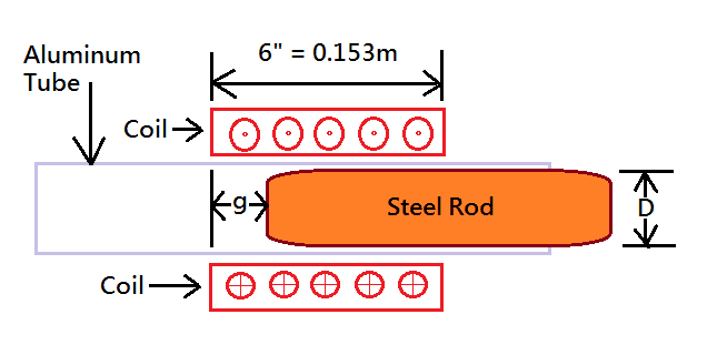

I wasn't measuring anything in an intellegent way. I had a thin steel rod in the tube that I was holding with my hand, while I increased the amperage
Could you please provide the following data?
How much force do you actually expect from the electromagnetic coil? 10 or 20 or more grams force?
How thin is the steel rod you use? What is its diameter?
Do you know how many turns have actually been wound on the tube?
What are the lengths of the coils and the steel rod?
...etc
...etc
The rod was more than half the diameter of the tube, filled most of it up. 1200 turns. the coil is six inches long, the rod was maybe a foot. I am not sure how powerful I am expecting it to be but I would hope 1200 of feet of 17AWG being powered by well over 30V would be at least more powerful than a fridge magnet, if not much more.

Let's roughly estimate how much force the device will generate.
Equation : F = ((NI)^2 u0 A) / (2g)
Assumptions : -
N = Nos. of turns = 1200
I = Current = 2A
uo = permeability of free space = 1.257 *10^-6
A = cross-sectional area of the steel rod = 50mm^2 = 5*10^-5 m^2
g = air gap as show on the image = 20mm = 0.02m
The magnetic reluctance in the space outside the coil is assumed to be small, so its effect can be ignored
Result : -
F = 0.455N = 46 gram-force
By the way, I hope that the structure shown on the image correctly describes the device you are using.
Now we can see the shortcoming of not installing an external magnetically permeable return path, normally the force should be much and much stronger when the gap (g) length is shortening. However, the effective magnetic reluctance in the outside space is actually not so small when there is no dedicated return path, therefore, the outside space magnetic reluctance will become comparable to the gap magnetic reluctance as the gap length reduced to a certain extent, and as a result, the expected force at this time will be reduced.

That looks exactly like my unit. The aluminum tube is .125 inches thick. What do you think I could do to safely make this magnet a lot stronger? Different wire size, amperage, or materials?
How do I construct a return path
Find an iron tube that fits neatly over the coil, cut it to the length of coil. Cut a slot the full length of the iron tube to prevent eddy currents around the tube.
Get two iron washers that fit neatly on the aluminium tube. Cut slots in the two washers.
Assemble tube onto coil, then slide a washer on each end with slots lined up with the slot in the tube, outside of the washer in contact with the iron tube.
The outer return magnetic path is through first washer, through tube wall, and then through second washer. The sliding rod is the internal magnetic path.
