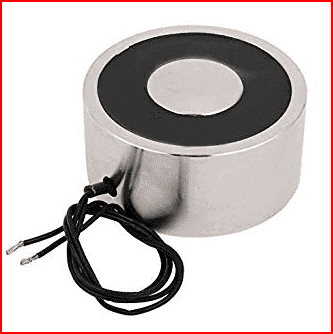

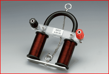

I didn't read the whole thread in detail, but you understand that you need both the N and S pole faces of the electromagnet to be in contact with the flat face of the ferrous object you want to lift, right? Otherwise the lifting force will be greatly reduced.
So you need to think about how you are going to have both the N and S pole faces of the magnet be coplanar. The usual solutions are to use a Horseshoe style magnet, or a Cylindrical magnet...
https://int.frederiksen.eu/admin/public/getimage.ashx?image=/Files/Images/ecom/products/frederiksen/331700_18_6.png&crop=5&Width=460&Height=320&AlternativeImage=/Files/Images/ecom/products/_dummy-product.png
243747
https://images-na.ssl-images-amazon.com/images/I/412HbOdxvDL._SX342_.jpg
243748
