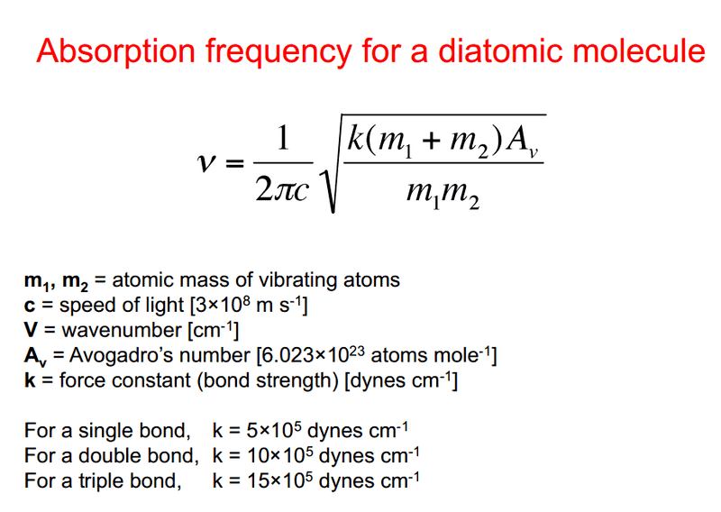

However, this lecture has a very simple formula on page 8; of course it only gives one frequency, so it is based on a very simple model: http://www.geo.mtu.edu/~scarn/teaching/GE4250/absorption_lecture.pdf
But the lecture is also worthwhile - it provides a great deal of information, but not much on N2.

When I calculate, I get a result of wavenumber in terms of s/(m√m) whereas it actually in 1/m. How can it be correct?
I don't know where that equation came from, and I don't trust it.
Search for Chapter 6 Ideal Diatomic Gas;
This lecture goes through a typical derivation process ... if you read it carefully you may find out how the above formula was generated, and its limitations.
Ok, from the equation v=(1/2∏)*√(k/u), and k=22,6*105dyn/cm for N2, the wavelength of vibration has been found 13517,28566 nm. This is way too long, I expected ultraviolet bands.
By the way, I took the previous equation from http://www.geo.mtu.edu/~scarn/teaching/GE4250/absorption_lecture.pdf pg:8.
Is there anyone to verify?
