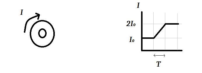

A small circular metal ring of radius r is concentric with a large circular metal ring of radius 10r. Current in the outer ring flows counterclockwise due to an unpictured power supply. By adjusting the power supply, you can adjust I, the current in the large ring. The graph below shows I(t). Notice that I increases linearly from I0 to 2I0 from time t = 0 to time t = T

So I attempted a, b, and c.
For:
A. I understand that from 0 - T and from T on, it will be zero because the flux isn't changing (current is constant) and , it will be -I0 in between the T interval.
B. I got ρ(2πr)/a = R
C. I don't know if this is right, but I came up with B = μ0Ilarge/(2πr+2π(10r)) - μ0Ismall/(2πr)
D. For this part, I'm not too sure how to approach this.

PhysixChick said:
c. Using the Biot-Savart rule, find the magnetic field, B (magnitude and direction) due to the large ring at the center of the small ring when the current in the large ring is 1.5I0.
In your answer you have involved current in the small ring. It is somehow absolutely right what you are doing, but it is just not an answer to the question.
PhysixChick said:
d. When the current in the large ring is 1.5I0, what is the current in the small ring? Neglect the small ring’s self-inductance. Answer in terms of R, r, I0, T, and any universal constants. The B field can be taken as uniform over the small ring.
The induced voltage in the ring: V = dΨ/dt, Ψ is the flux passing through the small ring.
Hesch said:
In your answer you have involved current in the small ring. It is somehow absolutely right what you are doing, but it is just not an answer to the question.The induced voltage in the ring: V = dΨ/dt, Ψ is the flux passing through the small ring.
Just curious though, what do you mean? I'm not trying to be sarcastic (I know tone of voice and emotions don't translate well through text), but how is that not the answer to the question? Because it's asking for B (magnetic field) and that's what I solved for.
And for the current, I would find the rate of change of the flux, which equals the potential difference, and then I would divide that by R (found in previous part, b) and divide to find current? Is that what I'm doing here?
In the question you are asked to find the magnetic field due to the large ring. Well, english is not my language, but I read it as you must only regard current in the large ring, not in the small ring.
Tell me if I'm wrong: It's your language, I assume.
Yes.
( There is no potential difference in the ring, but there is an emf ).
