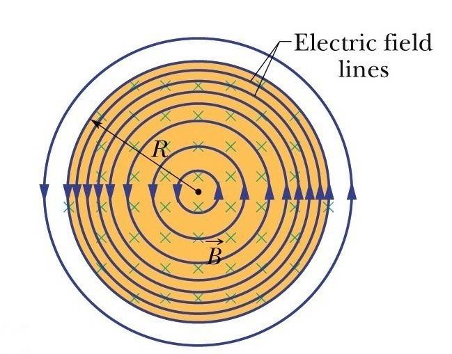

OK, good. You're right, there won't be any induced current in the non-conducting ring. But there will be an induced electric field that will exert a force on the net charge of the ring. If the magnetic field is confined to a region of circular cross section, then the induced electric field lines will be circular as shown in the figure (B is assumed to be increasing in the figure). So, if the ring is placed so that the center of the ring is at the center of the cross section of the region of B, then you can see that E would be tangent to the ring at each point of the ring.
If the ring is not placed at the center of the region of magnetic field or if the region of B is not circular, then E would not be tangent to the ring at each point of the ring. But, you can still show that the net force on the ring due to the induced E field will be the same as long as the B field is uniform inside the ring.

Thank you for the diagram. :)
Now, how do we generalize the direction of induced electric field? Is there a rule we should follow?
I think it is Lenz's law?
As Basic Physics says, use Lenz's law. The direction of E is such that if it did set up a current in a conducting ring, the current's B field would oppose the change in flux of the external B field.
