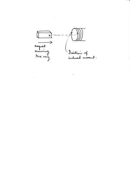

But where do I look to tell the clockwise/ anti clockwise? Do I look at the solenoid in a vertical way meaning that the long solenoid is facing me or do I look at the cross sectional area of the solenoid, meaning I see a circle? I think I should see it in the vertical way right? Because if I look at the cross sectional area it changes if I look at it from the other side... but I'm unsure about this.

Your first point: if there is no current because the circuit isn't closed, there will still be an emf, and its direction can still be figured out from Lenz's law, e.g. by considering the poles that the solenoid would have, if the circuit were completed!
As for which way to look at the solenoid, I'd look end-on. See diagram. Statements in terms of clockwise or anticlockwise are, imo, of little use without diagrams.

But if there is no current then how can there be a induced pole to oppose the magnet?
Please read my first paragraph again, carefully. The rule is based on the current that there WOULD be, and the consequences of that current. The rule gives you the direction of the emf even if there is no current actually flowing.
Note that I'm not attempting to give you a mechanism for HOW the emf is induced. That's another story, which I didn't think you were asking about.

I thought that the emf has no direction? Sorry if I'm unclear on this but will there be a force opposing me? Because since its the current that results in the poles being induced then since no current means no force? Thanks dorbtje help!
Imagine you move a rod of conductor containing positive charge carriers through a magnetic field. The field is vertically down, the rod lies East-West, and you are pushing it North (in a direction at right angles to itself). The charge carriers will experience forces to the West, along the wire, even though they can't flow (because we haven't given them a complete circuit). These forces arise from the so-called Motor Effect – the force on a charge carrier moving in a magnetic field.
