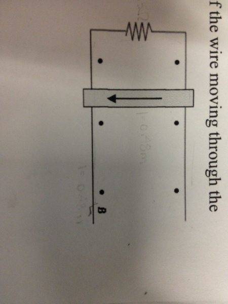

A 425 mA conventional current is induced in a 48.0cm wire moved through a magnetic field. A 11.5 Ω resistor is connected to the wire as shown in the diagram below. If the magnetic force acting on the wire is 323 mN, then determine the direction and magnitude of the velocity of the wire moving through the magnetic field.
(Diagram is attached to this thread)
B=F/IL
EMF=BlvsinΘ
V=IR
My first step was to solve for the magnetic flux using B=F/IL
B= 323x10^-3 / (0.425A)(0.48m)
B= 1.5833333T
For my second step I found the Voltage of the current and resistor using V=IR
V=(0.425A)(11.5Ω)
V=4.8875V
For my third step I used V=Blv to solve for velocity
4.8875/[(1.583333T)(0.48m)= v
6.430934591m/s = v
and then I plugged it into the formula EMF=Blvsinθ
EMF=(1.58333)(0.48)(6.430934591)(sin90°)
EMF= 4.8875V
I know this is mostly wrong but I didn't know any other way to attempt this.
Please help!
Why this doubt? I'd have done the same (except re-calculating emf at the end, perhaps).
Which step is tehe one you doubt the most ?
Apart from too many significant figures in the final answer, I do not see anything wrong in your solution.
Because I am missing direction. I feel I should use the voltage I get from solving for V as EMF to solve for velocity. I'm just very unsure about the actual EMF step and if the direction would be to right because the number is positive.
