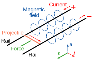

Two parallel electromagnets situated symmetrically on either side of the straight section of an oval track propel a wheeled trolley along the track, so that the trolley is in continuous motion, as long as the current is supplied to the electromagnets.
Is this workable? Does the entry and exit speeds of the trolley have any effect on the continuity of motion of the trolley?

The reason for using an electromagnetic rail gun is that much higher projectile can be obtained than by using permanent magnets, for example if the electromagnetic railgun can accelerate a projectile from 0 upto 6,000 kmh as opposed to the 0- 40 kmh or so we see on Discovery Channel for example, or those common experiments on You Tube using permanent magnets.
aeroseek said:
Does this article and diagram correctly describe the operation of this device?
No. That article describes what a colleague of mine (who built one in his garage - that's a different story and less exciting than it sounds) calls a "real" rail gun. You will notice that although it is powered by electromagnetic forces, it doesn't use electromagnets as you're describing.
(The currents and voltages involved are also extremely dangerous)

What works is an "electromagnetic railgun" (as stated in the title and described in the Wiki link) that propels something within on a circular track.

It's not an exact equivalent. Permanent magnets create a static magnetic field. The magnetic field created by the railgun rails is not static, it changes with the motion of the projectile:
To clarify - while the magnetic field in railguns are not static, you can use electromagnets to generate a static magnetic field. There is no contradiction between different statements in this thread, as they don't refer to identical setups/situations.
To clarify further - When the electromagnets generate a static magnetic field, they cannot propel anything continuously on a circular track, just like permanent magnets cannot. The original post didn't specify what kind of magnetic field the electromagnets generate, and the title implied it's dynamic like in a rail-gun.

As far as I understand you can't reproduce railgun described in wiki with static magnets.

1) Yes, the speeds will decay over several loops in the PMRG case, until it will get stuck. And of course you can tell the difference by the cables providing electrical power in the EMRG case.
2) Yes, if begin & end of the tunnel are arbitrary, you can find a section where the object speed increases, if it manages to reach the begin.
3) Yes, you can match the speed up for the first loop. But in the PMRG case the second loop will not have the same speed at begin.

Similarly in EM-railgun, the current and thus magnetic field disappear, when the projectile leaves the rails.
