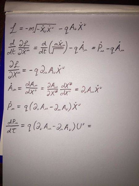

Hi there,
Over the last couple of weeks, I have been learning about the relativistic description of electromagnetism through Leonard Susskind's Theoretical Minimum lectures, and although I have managed to follow it, there are some parts which I am becoming increasingly confused by, not helped by the fact Susskind uses the (-+++) convention rather than the seemingly more popular (+---).
Is the definition of the electromagnetic tensor different depending on the convention? I am aware that the matrix changes (the contravariant and covariant forms are multiplied by -1 when moving between conventions), but does the definition of each component in terms of the vector potential change?
The reason I ask this is because when deriving the relativistic Lorentz force from the Lagrangian:
L=-m√(-dXϑ/dt dXϑ/dt)-qAϑ dXϑ/dt
I always seem to get the following answer (using the (-+++) convention):
Which is the negative of what I would expect from the definition of the Electromagnetic Tensor.
Any help would be appreciated, and thanks in advance.
Note that there are also conventions regarding the index structure of F...
the ;-notation vs the ∇-notation.
Maybe the Lagrangian should be:
L=-m√(-dXϑ/dt dXϑ/dt)+qAϑ dXϑ/dt
when using the (-+++) convention?
