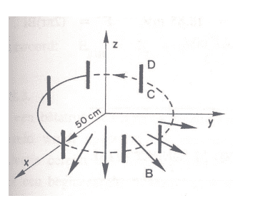

A conductor CD with a length of 30 cm is parallel to the z-axis and rotates at a distance r= 50 cm around this axis with a rotational frequency of 120 revolutions per minute in a radial magnetic field B in the r-direction.
1) Calculate the EMF if B is 0.25 T.
2) A direct current I = 4.5 A is sent through this conductor according to the positive z-axis. Then calculate the work done W at 1 single revolution of the conductor around the z-axis.
3) Also calculate the power P required for this.
Look at solution.
For 1) I used $$V=Blv=Blwr$$, where $$w= \frac{4\pi rad}{sec}$$, $$l= 0.30m$$ and $$r=0.50m$$.
I got 0.5 V.
For 2) I used W=Vq=VIt, where $$q=It$$, where t=0.5 s, we get 1.125 J.
For 3) I used P=IV, we get 2.25 W.
Are these correct?

So, for Q2), you must first answer the question: what force is exerted on a 0.3m long conductor, carrying a current of 4.5A perpendicular to a 0.25T magnetic field?
Like Q2) I don't believe you are meant to assume the emf is the applied voltage. You don't know the applied voltage. You are now considering the system acting as a motor, not a generator. You should use your answer to Q2).

I believe the answers are correct. So what are your concerns here? I don't understand some of the dialog.
And the question is sort of artificial because it is difficult to have a current without a complete circuit and a radial B field is also an odd duck.

If you evaluate ##\mathscr E = Bl\omega r## it gives ##\mathscr E =## 0.47124V.
You’ve rounded to 0.5V (ok) but then used this rounded value in Q2) and Q3).
It's worth noting that using the unrounded value for emf:
- the work in Q2) is 1.06J (not 1.125J);
- the power in Q3) is 2.12J (not 2.25J).
It makes a significant (pun intended) difference!

Yes good catch. But I dislike this problem because the topology is very wierd: in particular how does one build such a scenario in a real world. Radial B fields and currents in disconnected segments.
Likes milkism
Yep, that's very weird.
I can see the disconnected segment as a piece of a very big closed loop, say the Earth's circumference, and the question essentially asking to find the work per unit length. It's the radial field that bothers me because it violates the "no magnetic monopoles" Maxwell equation ##~\mathbf{\nabla}\cdot\mathbf{B}=0.##
Likes milkism
A little convoluted but…
For a pretty good radial field, use the gap in a loud-speaker magnet as shown in cross-section here:
https://mynewmicrophone.com/wp-cont..._Moving-Coil_Loudspeaker_Driver_Diagram-1.jpg
Put a vertical conducting rod in the gap. Have a flying lead connected to the top of the rod and some rotating mechanical support to keep the rod aligned as it moves around the gap.. Have a ring of mercury at the bottom of the gap providing the lower electrical contact to the rod.
Voilà!
