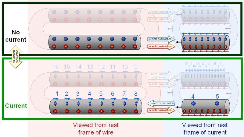

DaveC426913 said:
This is a new one one me:
See here:
And this diagram by DrGreg:
From this old thread:
https://www.physicsforums.com/threa...-of-electrostatics.577456/page-3#post-3768045
