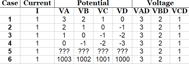

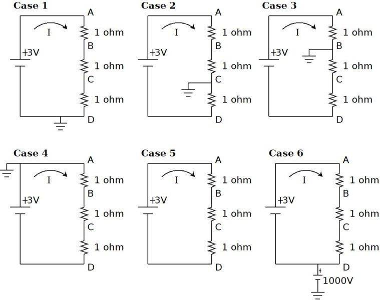

Students of circuit analysis should never use the term "electric potential V at a point", they should use only voltage difference between two points. Talking about potential at a point leads to confusion about definitions, as in this thread. It also leads to great confusion if we move the ground symbol around to different points in the circuit.
Likes DaveE, rtareen and hutchphd
Thanks everyone for your help! I think I understand enough about single loop circuits to atleast do the problems. Maybe someday when I have some time i'll try to understand them in more depth. But right now time is limited (since were covering 12 chapters in a single semester). But thank you all. I'm going to post a different question now. It will be a lot shorter than this one.
Yes, students must learn this first. But, frankly, it isn't that hard.
Then they have to learn to communicate with people out in the world who, more often than not, talk about voltages at a point as shorthand. Everyone that knows electronics knows that there is some implicit ground reference. True it's incomplete, but implicit references are common in all sorts of human communication for the sake of efficiency.
You're right about the shorthand, but it also gets confused with the potential from electrostatics which is the physicist's view. IMO, thinking about potentials or about electrons is a huge problem for beginning students. Those concepts impede learning. Here's an example from today.
A while back, I created the following to illustrate the point for students.
