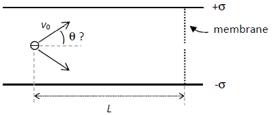

An electron is thrown halfway between two large plates, with an angle Theta and an initial speed v0. The resultant electric field caused by the plates is vertical and its magnitude is noted by E. A neutral and insulating vertical membrane located to the right of the electron has an opening halfway between the two plates.
V0 = 5 * 10^6 m/s
E = 550 N/C
L = 25 cm
a) Calculate the value of the parameter s ( sigma )
b) Say if the electron should be projected at an up angle (theta> 0) or down (theta <0) to pass through the opening in the membrane. Justify your answer.
c) Consequently to your answer in b), calculate the two possible angle values in order to that the electron can exit through the opening.
a) E = s / E0 so s is 4.87E-9
b) The electron will be projected at up angle since its charge is negative ( not sure if there's another reason behind it)
c)
Fy = 8.811E-17
Ay = 9.6718E13
Units!
That's not what the question asked.
Mike94 said:
c)Initial speed:
V0 = 5 * 10^6 * cos(theta) + 5 * 10^6 * sin(theta)
Without vectors in the equation it makes no sense.
Mike94 said:
The time it takes for the electron to exit
X= x0 + v0x * t
0.25 = 0 m + 5 * 10^6 * t
v0=5 * 10^6m/s. What is v0x?

haruspex said:
Units!
E = 505 N/C
E0 = 8.854 * 10^-12 C^2 / (Nm^2)
E = s / E0
So my s should be 4.87E-9 uC / m^2
Fy = qE
Fy = -1.602 * 10E-19 * 550 N/C
Fy = 8.881E-17 N
Fy = may
8.811E-17 N = 9.11 * 10E-31 kg * ay
ay = 9.6718E13 m/s^2
x = x0 + v0x * t
0.25 m = 0 m + 5*10^6 * t
t = 5E-8 s
vy = v0y + ay * t
vy = 0 + 9.6718E13 * 5E-8
vy = 4835894.6213 m/2
Theta = arctan(4835894.6213/5E6)
Theta = 44 degrees

After working for on it, I see it as a projectile:
R=v0^2*sin(2*theta) / |ay| => 0.25 m = 5E6^2 * sin(2*theta) / 9.6718E13 m/s^2
theta equals to 37.64 degrees or 52.3599 degrees
Quite so... as a projectile it 'lands' at its launch height, so vertical velocity is just reversed.
Not quite sure what you meant by vertical velocity is just reversed. Do you mean that my final angle will be 90 degrees minus the angles from the final vertical component.
Thanks.
Thanks.
I mean that if you throw a ball up with vertical velocity v and horizontal velocity u then when it returns to the height from which it was thrown it will have vertical velocity -v and horizontal velocity u.
