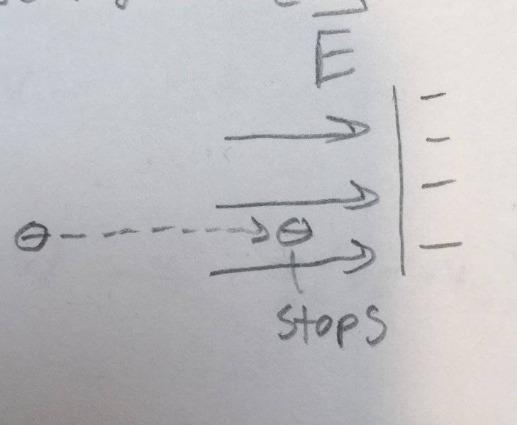

An Electron with an initial speed of 500,000m/s is brought to rest by an electric field
a)did the electron move into a region of higher or lower potential? I
b) what was the potential difference that stopped the electron?
ΔV=ΔU/q
ΔU=-W
a) my logic: if the electron is brought to rest that would mean the thing creating the electric field would be negative (since like charges repel each other). So I am imagining something like Electric Field.jpg attached.
Since I know that ΔV=ΔU/q, an electron would have a very high potential energy when near a negative plate (like in my pic). That means the closer it travels in the direction of the charged plate it is gaining electric potential based on the equation ΔV=ΔU/q, since q is not changing.
So I believe the electron traveled from a region of lower electric potential to higher electric potential.
when the problem states "did the electron move into a region of higher or lower potential" they are saying electric potential, correct? just want to clarify
b)
ΔV=ΔU/q
ΔU=-W
W=ΔK=(1/2)mvf2-(1/2)mvi2
combining these equations:
ΔV=-[1/2)mvf2-(1/2)mvi2]/q
the electrons is brought to rest so vf=0
so the equation becomes:
ΔV=(1/2)mvi2/q→(1.1387x10-19)/(-1.602x10-19)=-0.712V

What was the initial kinetic energy of the electron, given its initial velocity? Express your answer in Joules initially, and then in eV. What was the final kinetic energy in eV. What was the decelerating potential...? :smile:

Electrons don't have electric potential V. They have potential energy U = qV, where, for an electron, q = -1.6×0-19C. I suggest that you figure out the answers to the following three questions
1. Do electric field lines point from a region of high electric potential V to a region of low electric potential V or the other way around?
2. When an electron moving with some initial speed is stopped by an electric field, does it move from a region of low electric potential energy U to a region of high electric potential energy U or the other way around?
3. When an electron moving with some initial speed is stopped by an electric field, does it move from a region of low electric potential V to a region of high electric potential V or the other way around?

I think you meant while being brought to rest was it moving from a region of low electric potential energy U to a region of high electric potential energy U. The answer to this: Since it is being stopped this means it was traveling towards a negatively charged object (or group of objects). The closer you bring electrons to negatively charged things its electric potential energy increases (and its kinetic energy decreases to zero, which is why it stopped in the first place).
So It was moving from a lower electric potential energy to a higher electric potential energy.
kuruman said:
2. When an electron moving with some initial speed is stopped by an electric field, does it move from a region of low electric potential V to a region of high electric potential V or the other way around?
Using my answer to part 1 and the equation ΔV=U/q, if U is small then ΔV is small and vice versa. Therefore the electron went from a region of lower electric potential to higher electric potential.

Yes. They are referring to electric potential.
