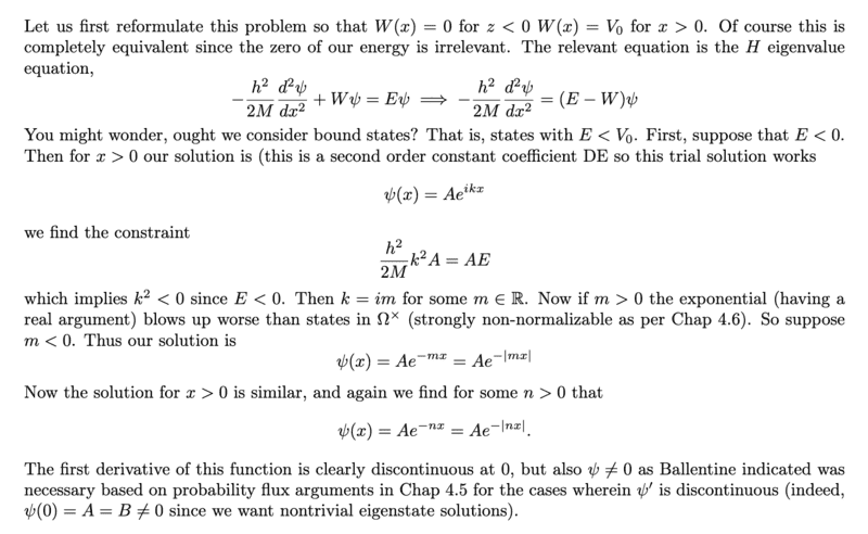

I have this so far and will continue on. Does this seem like a reasonable argument for excluding the $E<0$ possibility rigorously?
Your solution for ##x<0## (you mistakenly said ##x>0## again for the second case) is wrong. Also, the only time you're going to get discontinuities in ##\psi'## is when you have some sort of potential involving an infinity, which you don't have here. You want to construct a solution where ##\psi## and ##\psi'## are continuous at ##x=0##.
Sorry for not being clear, you are right re ##x>0##. In general, my strategy was to give a solution for ##x>0## and show that it could not be stitched together with the ##x<0## solution in such a way as ##\psi'## was continuous. Is that correct? Also why is my (intended) ##x<0## solution wrong?
Oh, I didn't notice you redefined the potential. With the new potential, you have to have ##E>0##. That should make clear why your ##x<0## solution is wrong.
I agree ##E>0##; to be clear, I was trying to show in this part of the solution (it's not a complete solution yet) why ##E<0## is impossible since it's not excluded on the basis of e.g. Hermitian operators having real eigenvalues a priori.
