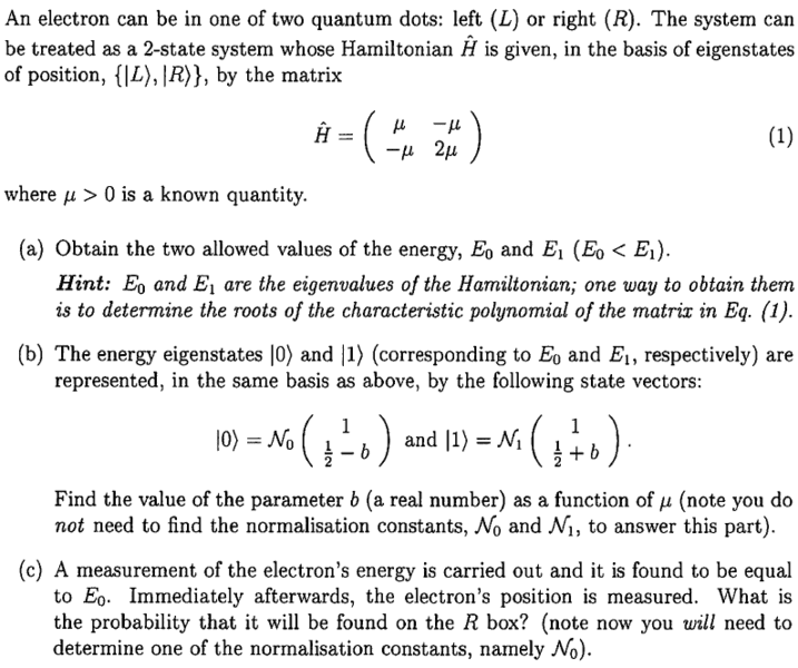

If possible could someone have a look at my working for this problem, I am not sure if I have carried out part b) correctly. I have done all three problem and carried through my solution to b) just to see if it did simplify out, which it didn’t which make me think I may have carried b) out incorrect. I have attached the question as a picture due to the amount of content.

b) finding the eigenvector
$$\begin{pmatrix}\mu &-\mu \\ -\mu &2\mu \end{pmatrix}\begin{pmatrix}A\\ B\end{pmatrix}-\left(\frac{3-\sqrt{5}}{2}\right)\begin{pmatrix}\mu A\\ \mu B\end{pmatrix}=0$$
Solving the top line
$$\mu A-\mu B-\left(\frac{3-\sqrt{5}}{2}\right)\mu A=0$$
I have kept ##\mu## in as it want ##b(\mu)##
if ##A=1## the I get the following
$$|0\rangle=\begin{pmatrix}\mu \\ \left(\frac{-1+\sqrt{5}}{2}\right)\mu \end{pmatrix}$$
I am going to ommit the normalising constants as they will cancel through, as they are the same, and as stated not need for this part of the problem.
$$\begin{pmatrix}\mu \\ \left(\frac{-1+\sqrt{5}}{2}\right)\mu \end{pmatrix}=\begin{pmatrix}1\\ \frac{1}{2}-b\end{pmatrix}$$
I do think this is wrong because I really can't understand why the above works, I understanding the if you scale and eignevector not matter what, the eigenvalue will still be the same, but, I can't see how the above is correct as in this case ##\mu=1## anyway carring on solving through I get the following for b.
$$b(\mu)=\frac{1}{2}+\left(\frac{\left(1-\sqrt{5}\right)\mu }{2}\right)$$

As I have stated I am not really sure if my b is correct, but can't really see any other way of making it a constant function

OK for part (a). For part (b), I think you've been thrown off course by the statement of the problem which implies that the parameter b will be a function of μ. Note the form of the Hamiltonian. μ is just an overall multiplicative constant. So, should the eigenvectors of H depend on μ?
No, I don’t think so because the of the fact alls you effectively is extending the vector in the direction it already going in. I originally thought this but then beacuse the question stated it as a function I was not sure.

Since ##\mu## cancels out in this equation, ##A## and ##B## do not depend on ##\mu##. So, ##b## will not depend on ##\mu##.
Thank for the response, I have realized what going on, I did cancel through originally and just had the value. But for some reason I seem to think when it comes to quantum physics "maybe this could be true" and forget the basics of maths, in part iv only just been introduced this year so I am still trying to wrap my head around more the concepts that anything, I have started going through Griffith which seem to be a very good book for the concepts, so hopefully I won't make silly mistakes like this again. Once again much appreciated.
