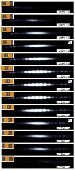

Sometimes it helps to view an actual experiment.
http://iopscience.iop.org/article/10.1088/1367-2630/15/3/033018/meta
You can read how they prepare and measure the electrons. I especially like this picture. The top left corner shows how much of the double slit is exposed compared to what type of pattern is seen. You can see the diffraction pattern even when there is only one slit open (picture marked P1 or P2) compared to when both are open (pciture marked P12).
Likes vortextor, Ostrados, PeroK and 2 others

First, thank you for this.
If they would have put detectors at each slit would the diffraction patterns have been observed on the detection screen?
Also, is the observed scatter of electron positions on the detection screen caused by the uncertainty in the electrons momentum which was inducted when the experiment attempted to localize the particle when it went through the slit?
I am saying it like this because I am trying to figure out if I am thinking about it properly. Feel free to tell me that I am not.

The relevance of Couder's experiment to quantum mechanics is theoretically justified here:
"Justification" is also much too strong of a claim. There's nothing wrong with Grössing's suggestion that quantum mechanics might emerge from a realistic non-local hidden variable theory of the sort that he is considering (although without a candidate theory there's only so far it can be taken), and Couder's analogy suggests one picture of what such a theory might look like. But that's not a theoretical justification, it's an idea about one possible area of exploration.
Likes bhobba
  • #34
Nugatory said:
That is not in any meaningful sense a "reproduction" of the quantum-mechanical double-slit. It's a completely different physical system governed by completely different physical laws and that happens to display interestingly similar behavior so is interesting as an analogy. Considering the ubiquity of the wave equation in physics, it is not surprising that such analogies exist - but an analogy is never the real thing. Thus, you may feel a high degree of confidence, but you shouldn't expect others to share it.
I think you are downplaying this a lot. Sure, interference experiments based on waves have been performed since Newton's time, but this is the first experiment to show interference effects with single particles outside quantum physics. Feynman thought it was impossible to imagine a classical mechanism for obtaining such a result, yet there it is.
I was under the impression that Grössing's proposal is local after all and what he calls "systemic nonlocality" does only refer to the influence of boundary conditions upon the particle. But it seems you are right, so I will retract my claim regarding the importance of his work in regards to Couder's experiments.
