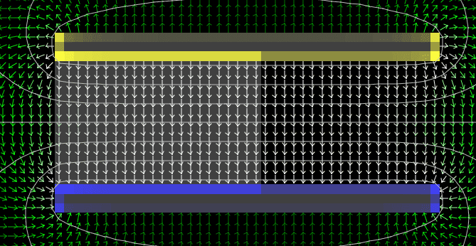

I don't see why the field lines can't bend. For example, if I half-filled the capacitor with a dielectric, so that there are field lines going from + to - electrodes of the capacitor just above the surface of the capacitor, wouldn't the induced polarization causes those field lines to bend and enter the dielectric, and thus, disrupting the field lines near it?
The electric field lines need not be normal to the surface for a dielectric, unlike a metal.
Zz.
In the case of the spherical dielectric there are surface charges presented along the curved surface which can interact with the external field. In the figure from the quoted post:
note that the field line entering the "equator" of the sphere is undeflected.
For the plate capacitor all of the induced fields are parallel to the main field, and no surface charges appear along the sides of the dielectric (I've ignored fringe effects at the edges of the plates):
But the fringe effects are likely the crux of the issue!

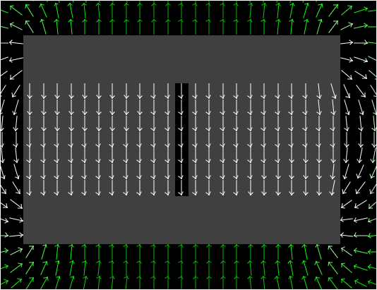

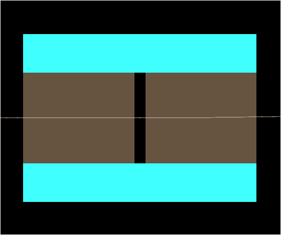

I found an on-line java applet here that allows you to set up a configuration of charges, charged plates, charged conducting plates, dielectrics, and a host of other options. The resulting electric field lines are calculated and displayed to varying accuracy.
Here's an screen snip of what I set up:
The blue blocks are charged conducting planes. Positive on top, negative on the bottom. The brown blocks are dielectric material.
Here's the resulting electric field:
The simulator interface is a bit glitchy, like losing the distinctive material type colors at random (that's why you can't distinguish the dielectric from the plates in the above image). It is interesting to add dielectric bits one at a time and watch how the electric field alters.
Likes vanhees71 and sophiecentaur
Interestingly, the presence of a dielectric seems to mitigate the some of the edge effects (fringing) at the edges of the plates. Here's a run with the capacitor half-filled with dielectric material:
This time the interface didn't lose the material coloring.
