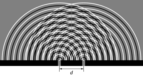

Your diagram is incomplete. A procession of wavefronts emerges from each slit, and each wavefront from slit #1 can interfere with any wavefront from slit #2 that it happens to "cross." You seem to be thinking that wavefront #n from slit #1 can interfere only with wavefront #n from slit #2.
[URL]http://upload.wikimedia.org/wikipedia/commons/thumb/f/f8/Double_slit_diffraction.svg/500px-Double_slit_diffraction.svg.png[/URL]
In the diagram above, there is a maximum wherever two black lines or two white lines cross, and a minimum wherever a white line crosses a black line.

I know I did not finish the diagram, thank you for the better one. As you can see on your diagram, on the right and left sides, there is a area where one wave (4 wavelengths actually according to that diagram) is chasing the other and there is no interference, so when the "wavy" electron spreads and reaches the detector, at first it has probability to be detected without interference. That is what I want to understand.
