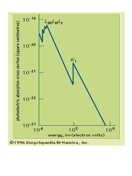

There are several ways photons can interact with atoms. This includes photoelectric effect, Compton scattering, pair production, bremsstrahlung, photonuclear reactions, etc. One you might be interested in is the photoelectric effect, in which all the energy of the incident photon is converted to potential and kinetic energy of a bound electron. The attached plot shows the probability (or cross section) on the vertical axis for a photon interacting with a lead atom, plotted against the photon energy on the horizontal axis. The probability is dropping very fast vs. photon energy in the 50 KeV range, but when it reaches ~80 KeV, the probability suddenly jumps up by a factor of ~5. The reason for the sudden jump is that when the photon reaches the binding energy of the innermost electrons in the K (or n=1) shell, the photon has enough energy to knock that electron out, so the probability of the photon interacting with the atom jumps up by a large factor. This is called the photoelectric effect. It can occur in solids, liqiuds, and gases. This can happen whenever the photon has enough energy to knock any electron off the atom, even if the binding energy is a few electron volts (visible light, etc.)
Actually, that is called "core-level photoemission". It is nothing like the photoelectric effect that most people are familiar with, and certainly NOT the same type that is described using the Einstein equation. That equation doesn't work that well when we go beyond photoemission in a standard metal's conduction band.
You need to be more careful what you are doing and not give misleading information here.
Zz.
