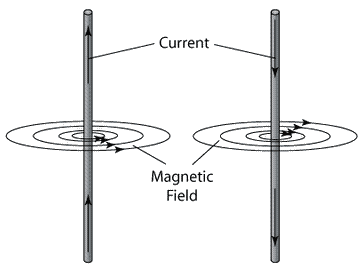

Hi! Did you ever get your answer? I’m trying to understand why it’s always clockwise relative to the direction of current.
It is clockwise because most people are right handed so clockwise follows a right hand rule. If most people were left handed we could have used a left handed rule and the physics would be fine. A left hand rule would make it counter clockwise
Thanks so much for the speedy reply!
What I meant was why is the field itself clockwise around a current carrying wire? We can experimentally verify this by a compass, which at idle points to earth’s north, then a current above runs and the compass will always snap into a position where north points clockwise around the current.
I understand why we use the hand we do, but why does the universe work this way?

Hi there. I don’t mean to belabour the point, but I’m really not talking about the convention. Pick a convention, any convention, the magnetic field will always be in this direction given the same direction of current. Again, not speaking about convention. Use the earth’s field as a reference for example. The question is why this way, and not the other?

Get a car battery and hook up a wire and get ready to pass a current though it. Ensure you know which way the current is actually flowing. Don’t worry about convention yet. Now get a magnetic needle on a swivel and let it adjust to earth’s field. Mark one side north, this is now your “convention.” Not pass a current through the wire. Whatever side you marked as north will now snap into position around the current showing that the magnetic field around current itself Is pointing north as clockwise.
The question is why does the actual universe itself, not the human convention, point clockwise around a current? Again. You can use whatever convention you want as long as it’s consistent. What makes it this way, and only this way, every single time?

The direction of the field is not a real direction. The direction of the magnetic field is a convention, specifically the right hand rule.
There is already a convention in the direction the current flows. This is a different convention, specifically the convention that the proton is positively charged.
What is not a convention is that two wires with parallel currents experience an attractive force. Regardless of which convention you pick for the sign of the charges and regardless of which direction you choose for the magnetic field, this fact holds.
As @Ibix said, this happens because with parallel currents the total energy stored in the magnetic field decreases as the wires get closer.
All other questions that are actually independent of the conventions can be traced to this fact. For example, the alignment of the compass needle that points roughly in the direction of Polaris can be used to infer the presence of a bound current on the needle. This bound current produces attractive or repulsive forces when placed near current carrying wires as above.
