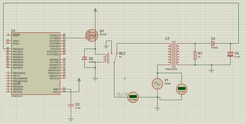

I'm building an electronic circuit breaker as follows,
I have some questions about the short circuit protection.

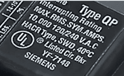

I tested it in simulation and it trips in about 11 ms. How would I work out the interrupt rating ?, which I read is the maximum short circuit current the breaker can interrupt, And also, How would I know if the transformer wiring won't burn ?, is their a way to calculate the wire temperature ?. I'm assuming 11 ms is a very short time for the temperature to rise and start burning the wires ?, do I need to work out the short circuit current of the transformer ?
And, in my design currently I have a peak detector circuit in which I am calculating the rms current using the peak voltage through the ADC. So far it works well in simulation, but I read in reality the AC sine wave is not perfect and that the true rms would be more accurate, though if I did a true rms then I would have to sample the entire waveform and then compare, so that would add 1/50 Hz or 20 ms to the trip time ?, making it slower
That's all for the questions for now
Any suggestions on improvements or what I'm doing wrong would be much appreciated, thanks
The interrupting capability depends on the ability to quench arcs between the contacts. That's not a thing readily calculated.
To visualize that, consider the time when the contacts are 1 micron apart. Then only one volt voltage difference means 1 million volts per meter gradient across the gap. A spark starts, ionizes the air and that creates a conductive path between the contacts.
If you are interrupting AC, the usual strategy is to trip at the moment of current zero crossing.p

Regarding the question about the current and heat-up time of wires: if the wire thicknesses are OK for the continuous maximal load and the tripping point is well set (so there is no chance of overcurrent for long time) then usually if the it's not a concern. The common way to solve such problems is to use a non-resettable thermal fuse close to the winding.

Yes. You have used an electro-mechanical relay. Those are slow! I shouldn't wonder if the main part of the 11ms is the reaction time of the relay.
On another note. As @anorlunda pointed out, breaking a current is much harder than you suspect. Here is a link to some commercial ones: http://new.abb.com/low-voltage/products/circuit-breakers. BTW - do not be confused by the "low-voltage" label. Low voltage means "below 5000V"!

Ok, so basically that depends on my relays current breaking capacity. I checked the datasheet and it says nothing about the contact breaking capacity,

I'm trying to use a triac and optocoupler design like this,
Though, it ends up being slower than the relay. Maybe because it waits for the zero crossing before tripping ?
Also, would it be better to find the true rms instead of the peak ?

Can you back up a bit. Requirements first, design second. What are you trying to accomplish? Can you list your requirements?

I am looking to build a 10A circuit breaker using a microcontroller. It will have programmable current and trip time settings. It doesn't have much requirements besides what I just said.
From what I know, if I use a relay then their is going to be arcing across the gaps, so I tried using a triac as shown in the previous post but the trip times are slower than with the relay.
I also read that true rms calculation would be a better way to find the current. Although, I think it would make the circuit breaker slower since a whole wave needs to be sampled before it compares.

You don't want to measure: you want to trip.
All you have to know is that/if in an application it'll be a fixed function between peak/limit current and (peak/limit) power.
BTW, I think you will need a small load in parallel with C4 (or to move R4 to the other side of the diode).

What transformer? Not the CT in your circuit, but rather the short circuit current of V1 in your diagram.
A snubber might help, but it needs to be tested to be sure.
You're skating on thin ice here on a safety related question. What are your experience and skills related to electrical safety?
