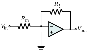

Given a circuit that includes Operational Amplifiers, double-switch - S, for two situations, 1 and 2. Type of switch - DPDT - Double pole double throw. Two diodes and two lightbulbs, L1 and L2.
Given:
Voltage of each diode = 0.7V during conductance.
Lightbulb L1 is red, and its resistance is 120 ohms
Lightbulb L2 is green and its resistance is 150 ohms.
The rest of the values are as they appear in the circuit
Answer the following questions:
A) Explain how the circuit works. What is the name of type of Op-Amp connection, in this type of circuit? At which condition of switch S is every lightbulb turns on?
B) Calculate Va, Vb, Vc, at points a, b, c, when S is at condition 1.
C) Calculate Va, Vb, Vc, at points a, b, c, when S is at condition 2.
D) Calculate the current at the red lightbulb when it's turned on. Calculate the current at the green lightbulb when it's turned on. Which lightbulb shines brighter?
A) (I'm really not sure what do they mean by explain the way the circuit works. I'm tempted to answer with "Read and electronics book, *******!")
But, basically, it's about current flowing and depending on the condition of the switch, and the amplification, the lightbulbs either light up or don't.
The Op-Amp in this type of connection is a NON-INVERTER op-amp.
When the switch is at case 1, we see that Vout is negative, so current flows from minus to plus... therefor L1 lights up.
When the switch is at case 2, current still flowing from minus to plus, though this time L2 lights up due to the connections.
B) They're all zero because the current skips the op-amp entirely.
C) Vc is basically Vout.
So, as per the formula I pasted above:
Vout = -R2/R1 x Vin = -40k/10k x 2 = -8V
Vc = -8V
Va = 0 (because there is no current source or anything between V+ and the ground point)
Vb is a bit more complicated
I use KVL to get:
-8 + (40k x It) + (10k x It) -2 = 0
It = 0.2 [mA]
Vb = It x R1 = 0.0002 x 10000 = 2V
Vb = 2V
I'll answer the last question once I see the rest of it is correct :)
Hi FP... good old negativr feedback opamp ! It is an INVERTING opamp
You are correct to recognise how the circuit works and you get Vout = -8V when switch in position 1 and Vout = +8V when in position 2.
Can you see how the diodes + lamp branches will respond to one output being -ve then being +ve?
Part(B) voltage at c will not be zero

How come Vout is once positive and once negative?
The way I see it it's always the same formula
Vout = -R2/R1 x Vin
Therefor no matter the switch condition Vout must always be negative!
with the switch in position 1 can you see that the + of the battery is connected to V-
via R1
And with the switch in position 2 the - of the battery is connected to the V- via R1

BTW - is this the way the current flows in the circuit for S1?
http://img828.imageshack.us/img828/5405/tukgn.jpg
No, it goes the other way. Remember Vout is -8V when Vin is +2V
When the switch is in position 2 the 2V battery is the other way round (upside down)
Then the current will have the direction you have shown

In both switch position Va and Vb = 0
In any op-amp, whenever you get that either Va, or Vb = 0, that means the other one is necessarily 0, as well?
I'm referring to the locations of a and b as they are in my current exercises near V- and V+
Edit: For S2, this is the case right? ->
http://img444.imageshack.us/img444/692/feely.jpg
In this diagram the - of the battery is connected to the - input. The amplifier is inverting so Vout will be + which means that current will flow from Vout to the right to go through the diode on the far right... just as you have drawn.
BUT the current goes to the left through the feedback resistor so your current through the battery part of the circuit is the wrong way round
Yes...and no. :rolleyes:
Va and Vb are equal providing the OP-AMP is operating as an amplifier and in the linear region. But sometimes OP-AMPs are used as comparators, where the output sits at either +Vcc or -Vcc and nowhere in-between, in which case it is not operating as a linear amplifier, and it therefore cannot make Va=Vb. (I'm sure you encountered this with an earlier OP-AMP circuit.)
So you have to be confident (or else assume) that it is operating as an amplifier in order to say Va=Vb.
Not there yet! Consider the top sketch. The battery's positive voltage is pushing current into the input resistor, as you show. With the feedback resistor arrangement here, this OP-AMP is inverting.
So what does that tell you should be the polarity of the OP-AMPs output voltage?

If you are happy that the output of the op amp goes -8V or +8V then you can picture the output to behave like a battery as far as the diodes and lamps are concerned.
I have attached a drawing showing how the op amp appears to the diodes and lamps. Can you see how current flows.
(I emphasise that this battery I have drawn is how the output behaves...it is not a real battery !)
Hope this helps:smile:
