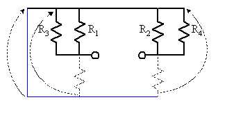

No, it's not. Those resistors are not in series. When V is suppressed (shorted) it makes the bottom rail and top rail all one node. That means, for example, the bottom terminal of R3 is connected to the top terminal of R1... so they're not in series...

So R1 and R3 are clearly in parallel. R2 and R4 also share that common rail so they are also in parallel. Then those two equivalent resistors are also in parallel which leads to a total resistance of 45.25. That's still pretty high though.
Using that as a resistance my current is off by a factor of 10 compared to the simulation when I divide by (45.25+10). I=.0004525 A or 452μA.
If I instead assume that the two equivalent resistors are in series I get RTH of 550Ω which I can use to find a current of 44.66 μA. That's still not what my simulation says (45.297 μA). Even though this is close I still think they are in parallel...

R1 and R3 are in parallel as you say. So are R2 and R4. From the perspective of the open terminals, those two equivalent resistances are in series.
You should be able to "see" the relationships in your mind's eye by allowing the connection points of components to "move" along the contiguous paths that comprise the node they are connected to. When in doubt, sketch intermediate transformations of the layout. For example, in this case if you understand the parallel connections of R1||R3 and R2||R4 you might sketch:
and see that the resulting parallel combinations are in series between the terminals.
