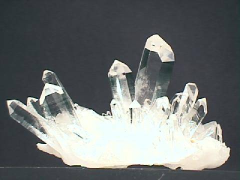

Silicon dioxide, which is the main component of common soda-lime glass is transparent in the visible spectrum, in most glasses you are dealing with oxides from the raw materials, not the elements individually.
The image below shows a SiO2 (Quartz) crystal.

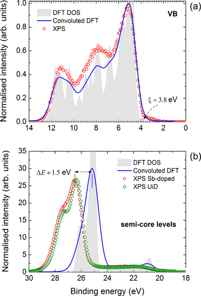

The binding energies of electrons are known for most materials, for many solids, you get bands forming from the hybridization of orbitals and the many-electron characteristics of these materials for the valence electrons. In this case it doesn't make sense to talk of binding energies for a particular electron like it does for hydrogen. For such materials, there can be an energy gap between the bottom of the conduction band and the top of the valence band, and electrons cannot have energies within this gap. It is this energy gap (the band gap) in semiconductors and many insulators which determines when a material directly absorbs light, by promoting an electron from the valence to conduction band. I.e. the light has to have energy equal to or greater than the band gap of the material.
Glasses are a bit more complicated, as they are amorphous, which allows them to have some states in the energy gap, however, they still behave quite like the crystalline equivalent.
An example of the valence band structure and how they can vary with similar materials is shown in the figure below. The valence band is directly measurable using photoelectron spectroscopy methods, or can be predicted using density functional theory, and compared to experimental results as per the figure below from S. Vasheghani Farahani et al. Physical Review B 90(15):155413
Photoelectron spectroscopy can also be used to measure glass samples, as in this paper. Here, figure 2 shows the valence band as measured by XPS for a slightly exotic glass. Equally slide 12 here, shows multiple electronic states occurring in another type of glass for the electrons not involved in the bonding.
