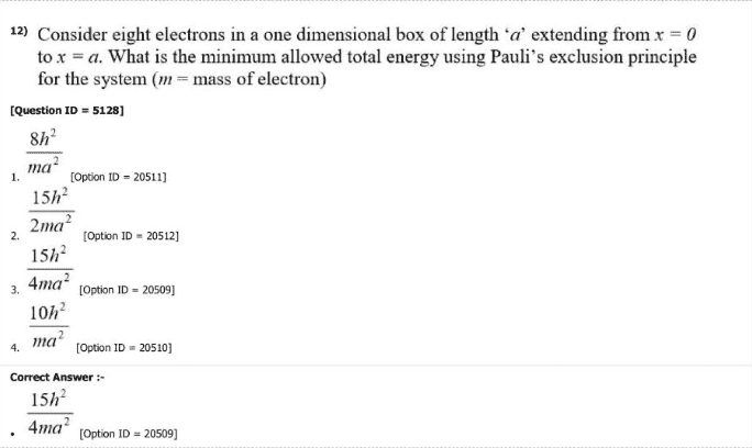

Consider eight electrons in a one dimensional box of length 'a' extending from x = 0 to x = a. What is the minimum allowed total energy using Pauli's exclusion principle for the system (m = mass of electron)?

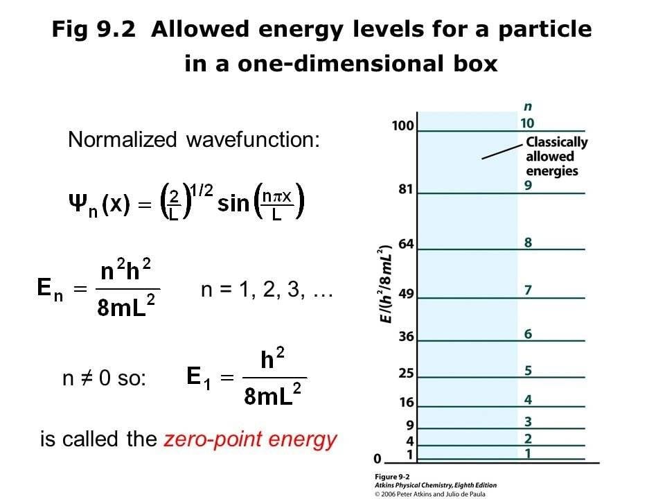

Energy of particles in a 1D box = n^2 h^2/ (8mL^2)
For the given problem, I know that the quantized energy for the particles in a 1D box is given by -
E(n) = n^2 h^2/ (8mL^2)
Here m = mass of electron
L = Length of the box = a
Now, since there are 8 electrons, but only 2 can occupy one energy level,
so I used n^2 = (1)^2 + (2)^2 = 1 + 4 = 5
So for a 'pair' of electrons, E = 5h^2/8ma^2
Hence total energy should be (since there are 8 electrons) = 4 * 5h^2/8ma^2
= 5h^2/2ma^2
Is my approach correct for attempting the question ?
Please guide.

How many electrons have you put in the ground state with ##E(1)##?
Only 2 electrons can be accommodated at a time.

Sir I think I should do it like this:
Put 2 electrons in ---> n = 1
Put 2 electrons in ---> n = 2
Put 2 electrons in ---> n = 3
Put 2 electrons in ---> n = 4
(According to Pauli's exclusion principle, and since n = 1, 2, 3, 4 correspond to top 4 'minimum' energy levels)
So that E(1) = h^2/8ma^2
E(2) = 4 h^2/8ma^2
E(3) = 9 h^2/8ma^2
E(4) = 16 h^2/8ma^2
and therefore the total minimum energy is given by: E(1) + E(2) + E(3) + E(4) = 15 h^2/ 4ma^2
You have eight electrons, not four.
PeroK said:
First, this is not right.
I put 2 electrons in each energy level starting from n = 1 to n = 4 to accommodate all the eight electrons.
So, what is your answer for the total energy?
According to me it is 30h^2/8ma^2 which is 15h^2/4ma^2
Which is only wrong, I think, because you're using the wrong formula.
That said, really, you made this far more complicated than it need be:
$$E_{tot} = 2E(1) + 2E(2) + 2E(3) + 2E(4) = 2(1 + 4 + 9 + 16)E(1) = 60E(1)$$
Sir I think it should be 30 E(1)
sorry for the double images
Okay, so you're using ##h## instead of ##\hbar##. So, you do have the right formula for ##E(1)##. Sorry about that.
Nevertheless, the total energy is ##60E(1)##.
Okay, so either the book's wrong or I'm wrong!
I get the same thing as you. The book is wrong.
