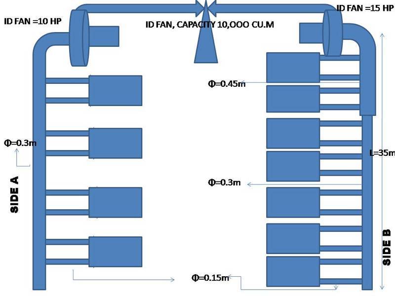

I've recently been put in- charge of reviving a Fume Suction System installed at the electroplating section of factory. After my stint in the army my engineering skills leave a lot to be desired, even though i am a Mechanical Engineer (by education not profession) so it is my request to PFers to help me out.
The Electroplating Tanks are of dimensions 1510mmX750mm on top, they are meant for electroplating with chromium, lead, nickel and various other toxic chemicals that emit highly toxic fumes when the dc current is switched on. The shop floor has been arranged in two parallel section with nickel and allied tanks numbering 1 to 4 on one side(Side A). Chromium, lead and other tanks numbering a 1 to 7 on the other side(Side B). Im attaching a layout and a few pics.

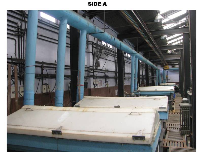

On Side A On side A, a common duct of dia 300mm is fitted in such a way that it runs paralled to the breadth of all four tanks(for about 35 Metres) and it is at height of about 3 metres from ground. Smaller ducts descend from the common duct in pairs and are fitted to the sides of the tanks along it's length. These smaller ducts have slits in them for suction. The bigger common duct is connected at it's terminal end to an Induced Draft fan for suction, driven by a 10 HP motor.

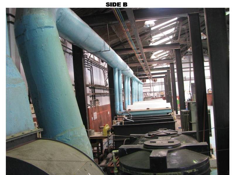

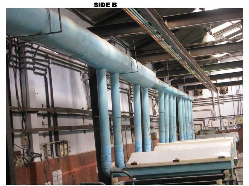

Side B Side B is similar to side A, only difference is that it has Seven tanks and the common duct has a telecscopic dia with a dia of about 450 mm for two tanks and from thereon 300 mm dia for the remaining 5 tanks. Induced draft at it's terminal end is driven by a 15 HP motor.
Now the exhaust of both Sides A and B is connected to a common duct which then goes into a Fume Scrubber.
The problem is that inspite of powerful motors for the suction, the suction produced at the tanks is very miniscule.
i) How can I Calculate the amount of suction I need to produce at each tank powerful enough to suck all the air and fumes surrounding the tanks.
ii) How do i measure the amount of suction actually being produced at the tanks right now.
iii) I need to understand weather the system designed and in place right now has been correctly designed or it just a stab in the dark.

Hey my fault, the diagram has been labelled incorrectly, the main fan you mentioned is actually the scrubber system. The 10 Hp and 15 HP fans are the only ones. And their capacities are slightly more than 10,000 CFM and 17500 CFM respectively.
I got hold of some design calculations that were used to design the system.
Size of the electrolyte tanks = 1510mmX750mm(i.e 4.9ft X 2.5ft )
(Now from some table), minimum ventilation rate required for a tank 2.5 ft in width is 500 CFM per FOOT of length of the tank.
Therefore for our tanks that are 4.9 ft ~ 5 ft in length Ventilation Rate (Vt)= 5x500= 2500 CFM per electrolyte tank.
Therefore Amount of air to be exhausted from Side A (with 4 tanks)= 2500 X4= 10000 CFM
Amount of air to be exhausted from Side B (7 Tanks) = 2500 X7 = 17,500 CFM
Total Amount of Ventialtion Required = 27500 CFM = 46,610 M^3/Hr
When i say the system is being revived i meant, that the contractor who has installed this system has not ensured proper functioning even though the system was installed fairly recently. So I've been put in charge of making it work and calling guy from outside is not an option as the obtaining the requisite clearance is a long drawn out procedure. I'm ready to slog it out and learn, time is not an issue here, just need to know what all needs to be done.
The diagram contains the measurements of a few aspects of the system like diameter of the circular HDPE duct pipes(indicated as ∅)the ducts, and it's length(35 M), the width of the slots on the electrolyte tanks are 1.25 inches thick and 1 Ft feet wide(3 slots on either sides of the tanks as despicted in the diagram).
(1) If you could mention what all other measurements are required i can make them and i'll plot it on the diagram again.
(2) And how do i go about plotting the performance curves of the ID Fans ? I need to be pointed in the right direction.

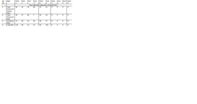

Im using a vane probe anemometer at various points on the electroplating baths to determine the face suction velocities at the vents. Attaching the readings here.
I'm just going to think aloud and bounce ideas off the thread.
