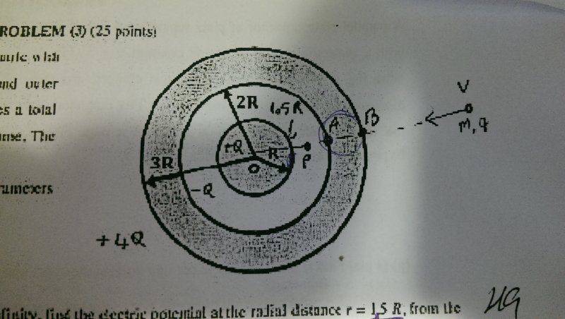

E=(1/4πε0)(Q/r^2) for R<r<2R
U= integral (2R,R) ( (ε0 E^2)/2*4πr^2 dr
I have no idea where the U-formula comes from. Any help would be appreciated.
