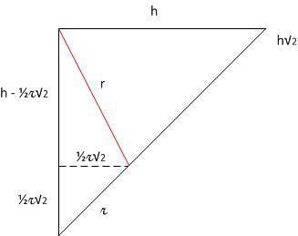

I am trying to understand a solved problem which is about finding electrostatic potential at point b of the following conical surface with a given surface charge:
I have attached the worked solutions to this post. In the solutions, I don't understand how they have got the expression:
##\bar{r}=\sqrt{h^2+r^2-\sqrt{2}hr}##
I appreciate it if anyone could explain how this expression was obtained.
Looking at the expression it looks like Pythagoras was used here with ##\bar{r}## being the hypotenuse. But when the vertical side is ##h##, how do we get ##r^2-\sqrt{2}hr## as the other side? I'm very confused here.
Any helps is greatly appreciated.

The triangle formed by ##h##, ##r##, and ##\bar{r}## is not a right triangle. Can you see how the law of cosines can be used to get the expression for ##\bar{r}##?
No, how can I use the law of cosines when the triangle is not a right angle? Should I be considering a different triangle? I really have no idea how the expression for ##\bar{r}## was obtained. :confused:
express r in ##\mathcal r##
Likes roam
The law of cosines applies to all triangles, not just right triangles.
See http://www.mathsisfun.com/algebra/trig-cosine-law.html
Likes roam
Thank you so much BvU for the diagram. It makes perfect sense now.
Thank you Tsny, I really appreciate the link.
