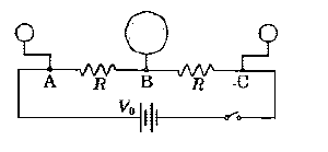

Three uncharged metallic balls of radii a, b and a respectively are connected to terminals A, B and C with the help of long thin conductors as shown in the circuit. Find changes established on each of the balls, when a steady state is reached after the switch is closed. Consider the balls to be at great distances from each other as well from the circuit and neglect internal resistance of the battery.
None
Theres a picture of the circuit attached.
I did not understand how to start the problem since we dont know the distance between the terminal A and the sphere to write the absolute potential at terminal A. So I looked at the solution and im afraid I dont understand it at all.
The teacher took the potential at terminal A to just be ##\frac{kq1}{a}##
I dont understand why this is the case firstly, the potential at terminal A should be less than this potential which we get inside and at the radius of the sphere.s
Secondly the absolute potential at A should be ## Potential due to sphere + V_{0}##
Then he wrote the equation
##\frac{kq1}{a} - \frac{kq2}{b} = \frac{V_{0}}{2}##
How is this correct? Shouldnt we consider the additional ##V_{0}## in the LHS and also the distances in rhe potnetial expression

Metallic balls are equipotentials.
  • The spheres are equipotentials at the potential of points A, B and C.
  • Since the resistors have the same value, the potential differences are ##V_{AB}=V_{BC}=\frac{1}{2}V_0.##
  • The distance between spheres is said to be "great"; this means that they can be considered isolated so that their potential relative to infinity is ##V_i=\dfrac{kq_i}{R_i}.##

I see I was thinking of terminal A to be an outside point for the sphere. Though now it looks more complicated how can we say that the potential due to the sphere as well as the wire at terminal A is kq/a... Any hints?
Imagine switches on the spheres connecting the three spheres to points A, B and C. We are in the steady state and the pshres are fully charged. Now open all three switches.
Question: What happens?
Answer: The charges are trapped on the spheres. The potential differences between adjacent spheres are $$V_{AB}=\frac{kq_B}{R_B}-\frac{kq_A}{R_A}~;~~V_{BC}=\frac{kq_C}{R_C}-\frac{kq_B}{R_B}.$$The circuit is isolated from the spheres and ##V_{AB}=V_{BC}=\frac{1}{2}V_0.##
Now close the switches.
Questions:
Do the charges on the spheres change? If so how and why?
Do the potential differences between spheres change? If so how and why?
Do the potential differences between points A, B and C change? If so how and why?

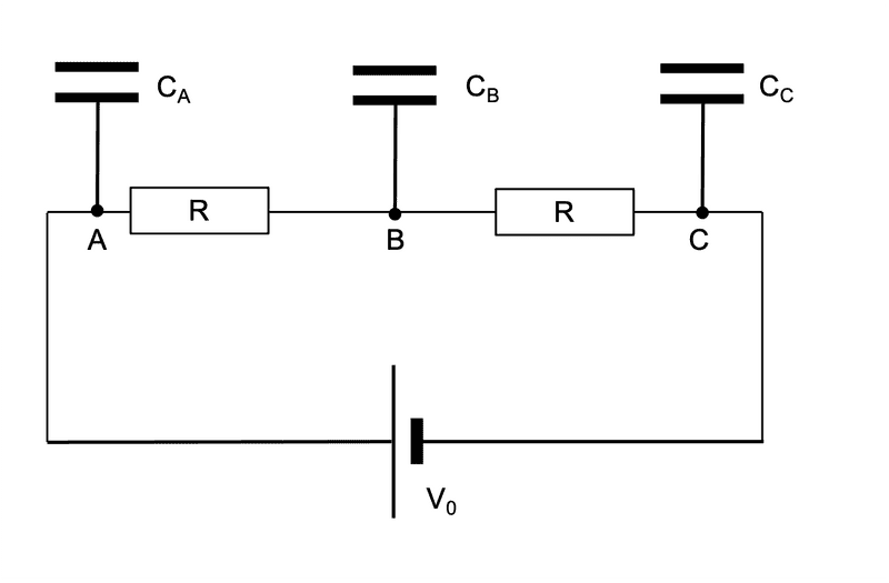

kuruman said:
No. Electrostatic potential is not the same as electrostatic potential difference. The potential the charged spheres is ##\frac{kq}{r}## relative to infinity where the zero of potential is defined. In other words, ##\frac{kq}{r}## is the electrostatic potential difference between a sphere an infinity. Here you know that sphere A is at the same potential as point A but you don't know the electrostatic potential at point A relative to infinity. That is why you have to consider differences of potential.
If i know that the absolute potential of the sphere is kq/r and I know that the potential of the sphere and point A is the same then wouldnt that mean the potential at point A is also kq/r?
Though I guess thats what I dont understand how did you conclude that potential at the sphere is same as the potential at point A

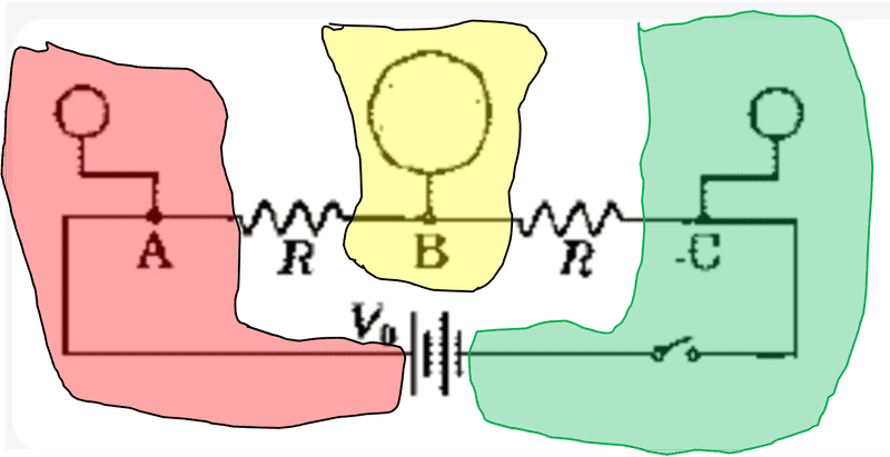

One more time, each sphere and all the connecting wires attached to them are equipotential. In the figure on the right all the conducting material within each colored shape is at the same potential. The vacuum is, of course, excluded.
  • The potential difference between all the conductors within red and all the conductors within yellow is ##\frac{1}{2}V_0.##
  • The potential difference between all the conductors within yellow and all the conductors within green is ##\frac{1}{2}V_0.##
  • The potential difference between all the conductors within red and all the conductors within green is ##V_0.##

Okay I think I get it now..
So to answer this
Questions:
NoI it will not change..?
The potential difference will not change since no charge from the sphere flows out..
No the potential difference between A B and C does not change as well..

FWIW...
##\frac{kq_1}{a}-\frac{kq_2}{b}=\frac{V_0}{2} ~~(1)##
##\frac{kq_2}{b}-\frac{kq_3}{a}=\frac{V_0}{2} ~~(2)##
Subtracting (say (2) from (1)) gives:
##\frac{kq_1}{a}- 2\frac{kq_2}{b} +\frac{kq_3}{a} = 0##
leaving an equation containing all three charges:
##\frac{q_1}{a}- 2\frac{q_2}{b} +\frac{q_3}{a} = 0##
Adding (1) and (2) gives:
##\frac{kq_1}{a}-\frac{kq_3}{a}=V_0##
##q_1 - q_3 = \frac {aV_0}k##
Although this gives a relationship betwee ##q_1## and ##q_3## it's not the key relationship that the (anti)symmetry imposes.

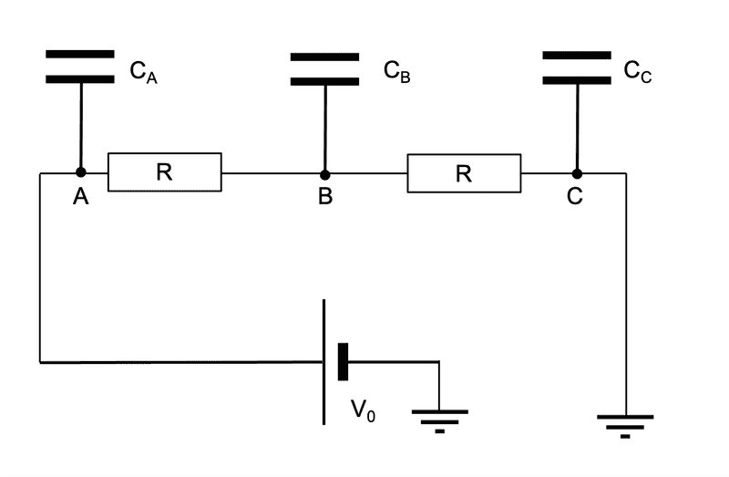

Perhaps a more instructive formulation of this problem might be to ground the right side of the circuit as shown on the right. The spherical capacitance with the outer sphere at infinity is ##C_i=4\pi\epsilon_0~R_i.## Then
  1. The electric potential at C is the same as at infinity, ##V_C=0.## So the charge on the sphere at C is $$Q_C=C_C~V_C=4\pi\epsilon_0~R_C\times 0=0.$$
  2. The electric potential at B is ##~V_B=\frac{1}{2}V_0~## relative to infinity. The charge on the sphere at B is $$Q_B=C_B~V_B=C_B=4\pi\epsilon_0~R_B\times\frac{1}{2}V_0=2\pi\epsilon_0~R_BV_0.$$
  3. The electric potential at A is ##~V_A=V_0~## relative to infinity. The charge on the sphere at A is $$Q_A=C_A~V_A=4\pi\epsilon_0~R_AV_0.$$
We can treat the original problem the same way. If we assume that the potential at C relative to infinity is ##V_C##. then
##Q_C=4\pi\epsilon_0~a V_C##
##Q_B=4\pi\epsilon_0~b( V_C+\frac{1}{2}V_0)##
##Q_A=4\pi\epsilon_0~a (V_C+V_0)##
Charge conservation requires that
$$0=Q_A+Q_B+Q_C=4\pi\epsilon_0\left[a V_C+b\left( V_C+\frac{1}{2}V_0\right)+a (V_C+V_0)\right]\implies V_C=-\frac{1}{2}V_0.$$Substitute in the three equations to get,$$Q_C=-2\pi\epsilon_0~a V_0~;~~Q_B=0~;~~Q_A=2\pi\epsilon_0~a V_0.$$
