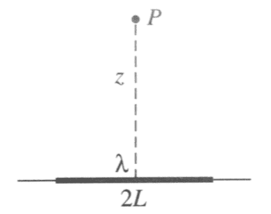

For a straight wire of length 2L carrying a uniform charge density ##\lambda##, find
1) potential a distance z above the centre
2) electric field E at that point,
3) energy of this charge distribution
1) and 2) I can do, and their expressions are
$$V(z) = 2k_e\lambda \ln{\frac{L + \sqrt{l^2 + z^2}}{z}}$$
$$\vec{E} = \frac{2k_e \lambda L}{z\sqrt{z^2 + L^2}} \hat{k}$$
3) however, I have trouble with. Here's what I tried thus far.
I know that the energy needed to construct some line of charge is given by the expression
$$W = \frac{1}{2} \int \lambda V dl$$
where ##V## represents the potential associated with some point on the line of charge.
This is where I don't know how to continue. How does one find the potential such a point?
I tried
$$V(x) = k\lambda \int_{-L}^{L} \frac{1}{|x - x'|} dx'$$
where ##x## represents some point on the line charge, and ##x'## represents points on that line I'm integrating over. This however, seems to diverge.
Assistance is greatly appreciated!

OK, here's my (I think) final take on this:
The wire has to have finite radius, otherwise you have infinite surface charge density which we don't allow. So you need to bring the radius into the picture. Call the radius a.
Then the potential of the wire is just 2kLλ/a. Now, as you accumulate charge to build up the wire to its full charge from zero, you can readily compute the work needed to do that by integrating over the charge accumulated from zero to 2λL.

I actually went to talk to a tutor about this in school. He said that I should find the expression for E field for general points and integrate over all space using this equation in perhaps spherical coordinates.
$$W = \frac{\epsilon _0}{2} \int E^2 \ dv$$
Is this something that makes sense?

Hi all, thank you for your helpful comments. Here's what I managed to find out
1) The problem was a bit of a mistake, my instructor set it without a solution in mind.
2) It was an insulator.
3) The potential and energy does diverge, but the instructor didn't delve into the calculations.
Apologies if this was a bit of a fruitless discussion, and thanks again for helping me consider some ideas that I previously never did.
