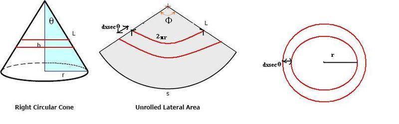

A cone made of insulating material has a total charge Q spread uniformly over its sloping surface. Calculate the energy required to take a test charge q from infinity to apex A of cone. The slant length is L.
Potential at the tip of the cone is calculated by adding potentials due to rings of charges .
Let us consider a ring having charge 'dq' at a distance 'x' from the tip and at slant height L'. L'=xsecθ where θ is the half angle of the cone .
The surface area dS of the ring = 2π√(L'2-x2)dx
dq=Q(dS)/(πRL)
V = ∫dV = ∫kdq/L'
This doesn't give me correct answer .I am not sure if I have approached the problem correctly.
I would be grateful if somebody could help me with the problem.
Hello, Tanya. How "wide" is the ring on the surface of the cone? Is it dx?
Hi TSny
The width is dxsecθ .That gives correct answer :smile: .
But I am having difficulty in comprehending (rather visualizing ) the difference between using dx and dxsecθ :shy:
My tiny brain can't differentiate between the two .I think if I use 'dx' then I am essentially covering the surface area of a cylinder ,not a cone . Am I right ?
But how is surface area of ring given by (Perimeter)(slant height) ? What is the shape of the differential element ? Is the ring in the form of a cylinder or is it more like a frustum of a cone?

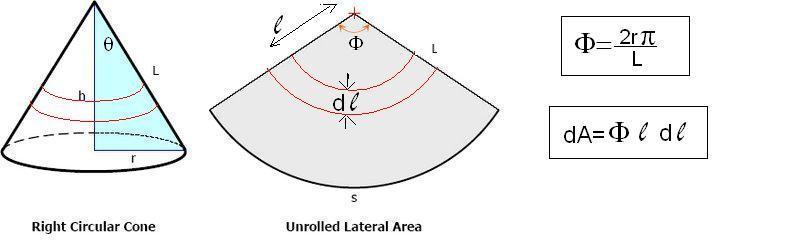

ehild said:
I can not follow your notations. What are x and L'?
ehild
'x' is distance of the center of the ring from the tip and L' is distance between the tip and a point on the circumference of the ring.
You can help your brain by imagining a much bigger θ. Clearly no cylinder, hence the secθ.
No need the centre of the ring mix in. The charge is distributed along the surface.
You get a circular section when you unroll the side of the cone. The centre of the circle is the tip of the cone. Can you see how to get the distance of a surface point from the tip? Do you see how to get the area of a ring?
ehild
Thanks ehild :smile:
Please have a look at the attachment .I have edited your diagram .Have I represented the ring (in red) correctly ?

That "ring" is not a ring really but part of the cone surface. You do not need x at all. Let be l the distance of a point on the surface of the cone from the tip. The unrolled cone has the central angle Φ=2πr/L. Then the surface element is lΦ dl. The area of the side of the cone is A=L2Φ/2.
ehild

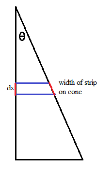

Hello TSny...
Could you please respond to post#4 and post#7 .
I am still not very clear how dxsecθ is the width of the ring.I understand it is more of a calculus concept . But if you could give your views , that would be very helpful .
Does the attached diagram help? If you "unwrapped" the strip off of the cone, it would be approximately a rectangle of width as shown in the diagram and length equal to the circumference of the circular cross section of the cone at the location of the strip.

It goes like this.
Since u assumed an elementry part over the sloping surface , u must be inegrating over the surface .
So,
Instead of using dS= 2π√(L'2-x2) dx
U must use dS=2π√(L'2-x2) dl.
Hope u understood. This will give u correct answer.
