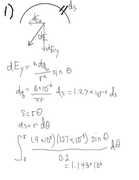

1. A thin rod bent in the shape of a semicircle of radius 20 cm is uniformly charged along its length with a total charge of 8.0 microC. What is the electric field at the center of the semicircle?
a. 7.3 x 10^4 N/C
b. 8.4 x 10^4
c. 5.7 x 10^4
d. 3.9 x 10^4
e. None
Answer: C

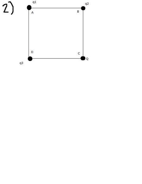

2. Two charges, q1 = +2.0 microC and q2 = -3.0 microC are placed on the two corners A and B of a square as shown. What should be the value a charge q3 placed at the corner D such that the net electrostatic force on a test charge Q on corner C is zero?
a. 3.0 microC
b. -3.0
c. -2.0
d. +2.0
e. None
Answer: E

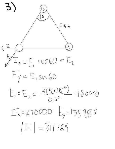

3. Two charges of +5.0 microC are placed on two corners of an equilateral triangle of side 0.50 m. The magnitude of the electric field at the third corner is:
a. 3.9 x 10^3 N/C
b. 2.8 x 10^4
c. 1.6 x 10^5
d. Zero
e. None
Answer: C

Please, I know there's a lot, but my exam is coming up and I would really appreciate if someone could show me what I'm doing wrong.
I don't think i see anything wrong with your working for question 1. Are the questions from a reliable source?
I think so; they are the questions that I got wrong on my last test for electrostatics. But it may be that the test bank is wrong, that has happened before. I'll have to speak with my teacher.
