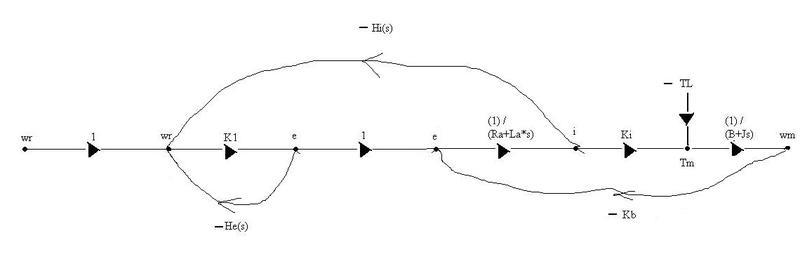

(a) Let K1 be a very high gain amplifier. Show that when Hi(s)/He(s) = - (Ra + La*s), the motor velocity wm(t) is totally independent of the load-disturbance torque TL.
(b) Find the transfer function between [tex]\Omega[/tex]m(s) and [tex]\Omega[/tex]r(s) (TL=0) when Hi(s) and He(s) are selected as in part (a).
Here is the block diagram of the system
http://img183.imageshack.us/img183/4163/dcmotorcontrol412.jpg
That image also has the signal flow graph that I drew for the block diagram...the SFG is probably wrong because I have very little experience with them. If you could help with this portion of drawing the SFG I would be appreciative.
(a) The only thing I can think of for part (a) is to use my SFG (which I believe is wrong) and use the Gain Formula to find the transfer function Hi(s)/He(s), then setting it equal to (Ra + La*s) should probably show the correct relationship. If this is the correct SFG and my method is correct, some help with the gain formula for this SFG would be appreciated because I'm confused as to how He(s) can be an input node.
(b) I don't even know what [tex]\Omega[/tex]m(s) or [tex]\Omega[/tex]r(s) represents.
Yes, it is wrong. I attach the right SFG.
Use it to obtain the transfer function and then substitue Hi/He with the given expression. I think it will work.
