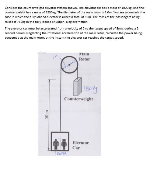

The problem is as posted in this picture[/B]
Hey guys/girls, my teacher gave us this problem which I am not sure if I have correct. Could someone please verify if my solution is correct.
As in my attempt
My attempt is scanned -

Your solution is correct, but you save time both for yourself and for the helpers if you do the solution symbolically, and plug in the data at the end. You would see that the radius of the rotor cancels.
ehild said:
Welcome to PF!
Thanks!
Ok, I will do it symbolically next time
