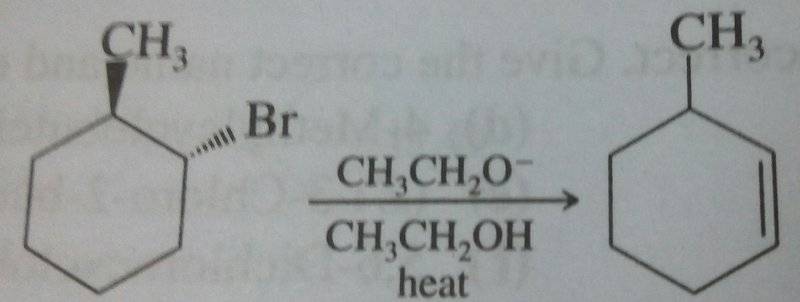

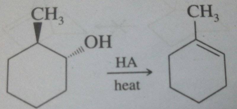

When trans-2-methylcyclohexanol is subjected to acid-catalyzed dehydration, the major product is 1-methylcyclohexene.
However, when trans-1-bromo-2-methylcyclohexane is subjected to dehydrohalogenation, the major product is 3-methylcyclohexene.
The attempt at a solution
Obviously, this is an E1 mechanism and the hydride shifts occur from either of the adjacent (to the carbocation) carbons in each case.
Also, -Br is a much better leaving group than -OH (but I don't know if it's relevant here).
The 3° hydrogen in case 2 is more acidic due to the greater -I effect of -Br. Right?
How will this affect the outcome of the reaction?
How can we account for the different outcomes anyway?

Is the mechanism the same in both cases?
Is there a hydride shift?
Is the leaving group -OH?

Well, I think case 1 is definitely E1.
Why? and do the same considerations apply for case 2?

TeethWhitener said:
Side note: this molecule doesn't exist (why?)
I'm sorry I meant 2-methylcyclohexene
Likes TeethWhitener
Oh, no. The 2nd is an E2 mechanism
Ok, so I see that in case 2, the base will attack the 2° hydrogen in preference to the 3° one.
Ok. (You still haven't said why, but) we can move on. What will the intermediate look like in both cases?

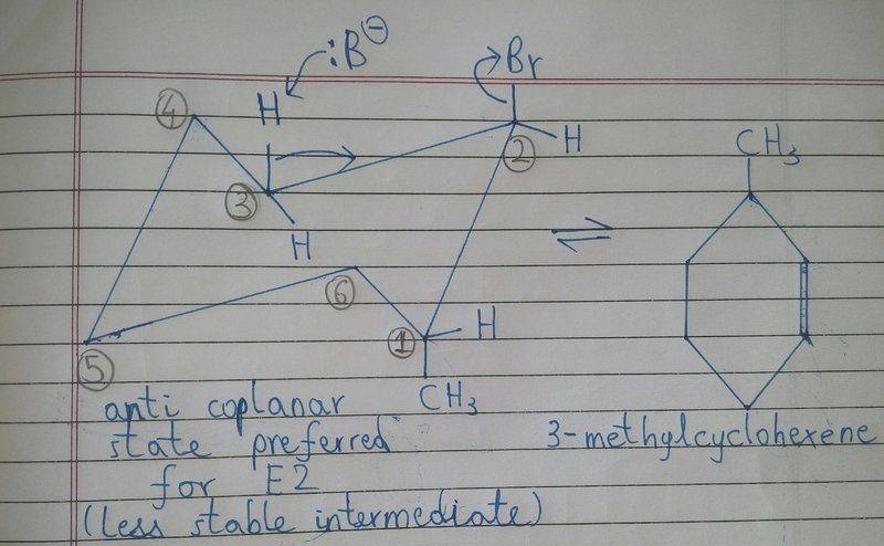

I got it. It has to do with the anti coplanar state preferred during E2 eliminations. In cyclohexane derivatives, the anti coplanar state is achieved only when the leaving group and the hydrogen adjacent to it are axial. Here, we've got trans-1-bromo-2-methylcyclohexane, whose chair confirmation would be as follows, and clearly the hydrogen on C3 is the only axial hydrogen adjacent to the -Br. Hence the product.
Of course, the more stable confirmation of the reactant will be with the -Br being equatorial & -CH3 being axial, but it has to interconvert to this less stable intermediate to react.

This is the right idea. The picture is almost correct, but on the carbon labeled 3, the axial H that is abstracted by the base will be pointed downward. The main point is that the leaving group and the proton have to be antiperiplanar in E2 reactions.
Good work.

Oh, right. They must point alternately upward and downward. Thanks
