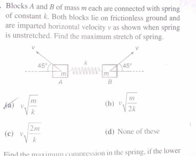

The Question is posted as a photograph with a. little change. One of the mass in the photo is equal to '2m' rather than 'm'. Now the block won't stop consecutively.
How would we approach the question?

What is your force balance on each of the masses at some arbitrary time?

This answer doesn't seem to relate to my question at all. Please write down for us the force balance equations you derived to solve this problem.
sir,
if both the blocks are of equal masses then the maximum compression would. be seen. at the time they both stop momentarily and consecutively the first time..Hence their kinetic enengirs would turn into potential for spring.
But my ques. of what if masses are unequal.
one is m and. other. is 2m.
Idont know how to find the answer then as both masses won't stop consecutively
You still haven't answered my question. What are the force balance equations on the masses?
Have you considered changing to a frame of reference where the center of mass is at rest?
Or you could consider writing down some equations as @Chestermiller has asked. Both roads lead to a solution.
