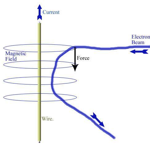

To the OP: (Referring to the diagram=post # 11) The magnetic force that an electron in the beam will experience is given by ## F=e(v \times B ) ## where the ## v \times B ## is a vector cross product. Once you compute the magnetic field ## B ## from the current in the wire, you should be able to compute the force if you can estimate the electron velocity. From the vector cross product you can compute the direction of the force, with or without an estimate on the magnitude of the electron's velocity.
Vandium, granted. Referring to my illustration, why would there be a force on the beam parallel to the current carrying wire? How does this force arise along that vector? The common SR explanation doesn't really connect to my example well because I don't see there being any charge directly perpendicular to the electron beam, you know what I'm saying?
The magnetic field ## B ## from the wire is in a circular direction around it. (Comes from Ampere's law and/or Biot-Savart's law). (The ## B ## is perpendicular to the moving current in the wire so that a ## v \times B ## can be parallel to the current.( ## v ## is electron beam velocity.))
Understood, JT, thank you. Charles, thank you, perhaps I need to clear up "vector cross product".
In a vector cross product, the result is always perpendicular to the two vectors of the product. Another item is, if the two vectors are parallel, the vector cross product is zero.
