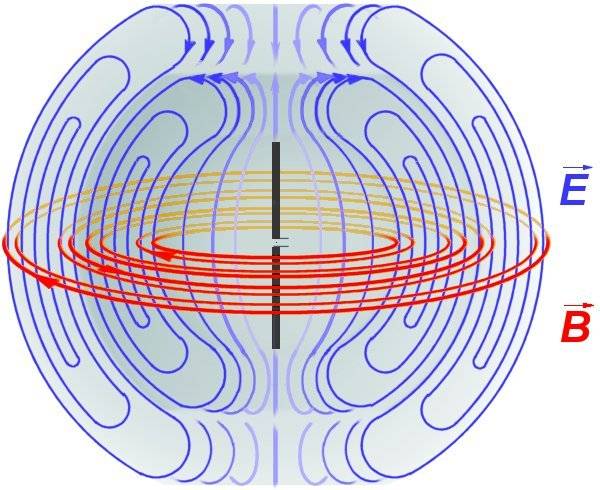

So i know that magnetic field lines are closed, in an electromagnetc wave how can be these lines closed? i cannot picture this in my head
I believe they look something like the following:
Is an antenna in the middle?
Yes there is. I believe that's the radiation pattern of a standard dipole antenna.
