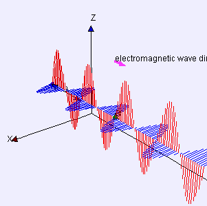

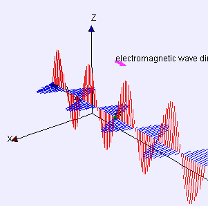

Does that mean that the E and B amplitudes of the generated EM wave will also be 180 degrees out of phase?
No. All EM waves propagate with the E-field in phase with the B-field. Although things may be confused near the source where you may actually have multiple sources.
Likes Klystron

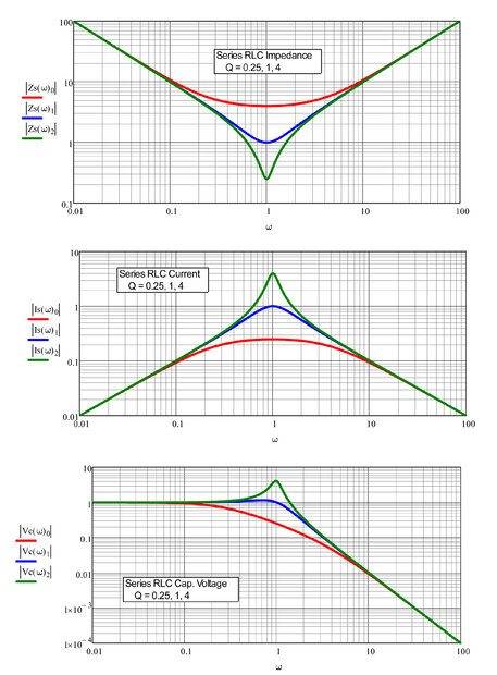

Consider just the capacitor's response first. If you drive it with a constant amplitude variable frequency voltage and measure the current, as you increase the frequency the current increases. But there aren't more losses, that's just how capacitors work. Then do the same with an inductor, and the current decreases at higher frequencies. When you combine them (in series), at some middle frequency you get a maximum. At resonance you also get a special effect where those impedances cancel and you get even more current. But that's just evident in the math of ## |Z( \omega )| = |(\frac{1}{j \omega C} + j \omega L)| = \frac{1 - \omega^2 LC}{ \omega C} ##. There are no losses (like R) in that equation but at resonance, you can make 0Ω.
It looks like this when you add some losses to it.
