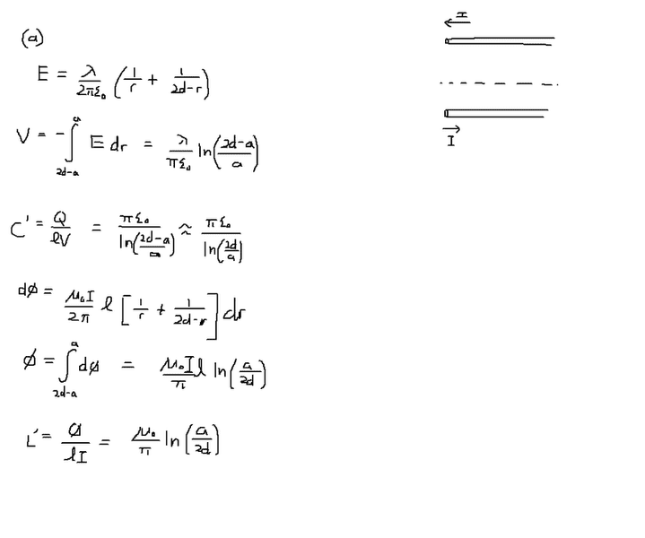

(a) Find the capacitance per unit length and find the inductance per unit length of a transmission wire above a infinite conducting plane. I used the image method

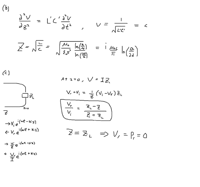

(b) Show that EM waves can propagate, and find their
speed and the characteristic impedance of the line.
(c) Find the characteristic impedance for no reflected power?

Part (a)
Part (b) and (c)
I got an imaginary value for the impedance, not sure if it's right. It implies there is a ∏/2 phase difference between voltage and current?

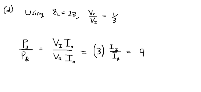

Part (d)
For part (d), I'm not sure why there would be a phase difference? If it is a short circuit, then there would be a phase change of ∏ (Vr/Vi = -1) if it is an open circuit then it would be completely reflected. What has ramping up the input frequency got to do with the phase difference between incoming and reflected wave?
V should be the potential difference between the two actual conductors, not between the wire and its image. Likewise, the flux ##\Phi## should be for a region between the plane and the wire.
L’ is the ratio of the absolute value of the flux and the current. So, it should be positive. The characteristic impedance should be a real, positive number for a lossless transmission line.

When [tex]l = λ, e^{jkl} = e^{j \frac{2∏}{λ} λ} = 0[/tex] so [tex] Z_{in} = \frac {0}{0} Z [/tex]
What is the value of ej2##\pi## ?
Note e is never zero. It's a point on the unit circle in the complex plane.
latest calculation below.
unscientific said:
It should be = 1.
Yes.
That gives [tex]2Z_L[/tex].
I don't get that result for Zin.
TSny said:
Yes.
Sorry, I got [tex] Z_{in} = Z_L [/tex]
So on the left side, we have impedance of [tex] \frac {1}{4} Z_L [/tex] and on the right side we have impedance of [tex] Z_L [/tex].So [tex] \frac {V_r}{V_i} = + \frac {3}{5} [/tex] (No phase difference)
So proportion of power reflected = [tex] (\frac {V_r}{V_i})^2 = \frac {9}{25} [/tex]
As for phase difference, I don't think there's a phase difference? it should be zero. (Anyway all cases include 0 or ∏)
I think that's right.
