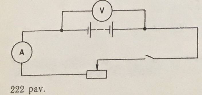

First of all, thank you for a response. You probably would have guessed that english is not my native language so that might be a part of the reason why you don't understand me :D And that my laboratory work is described in my native language, it doesn't make it easier, but I will try to explain as much as I can. I have used one power supply which was battery. Here is a picture of circuit

OK, so under 1. you have measured a voltage of 4 V ?
Then, under 2, you press the switch and measure 2 V and 1.5 A ?
And the hypothesis is that the battery can be represented by a circuit consisting of an ideal voltage source in series with an internal resistance. And the calculated internal resistance that would then follow is (4 V - 2 V ) / 1.5 A = 1.33 ##\Omega## according to
