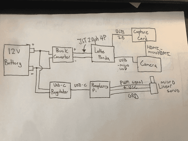

No PCB, as it doesn't really seem necessary. I'm a rookie so of course, me being wrong is possible. I'll attach a rough wiring schematic. I'll give you a better idea of the components we're dealing with. As this is an early prototype, there are issues we've identified which may well require additional components. The final design is meant to be autonomous, which we are not at yet. Max current draw is approximately 4.51A(its unlikely it'll be that high). Vibration will be a significant issue. The tractor is for agricultural applications. The tractor has a 12V battery.
What draws 4.5A from the 12V supply? That's about 54 Watts, or 11A at the 5V outputs.
Be sure to show the fuse for the 12V battery in your drawing. You may want a power switch in-line with the + lead as well.
You seem to show the Raspberry Pi powering the servo motor -- you likely want to power it independently if it draws any significant current (especially if the shaft stalls for some reason -- that's where you can draw a lot of current).

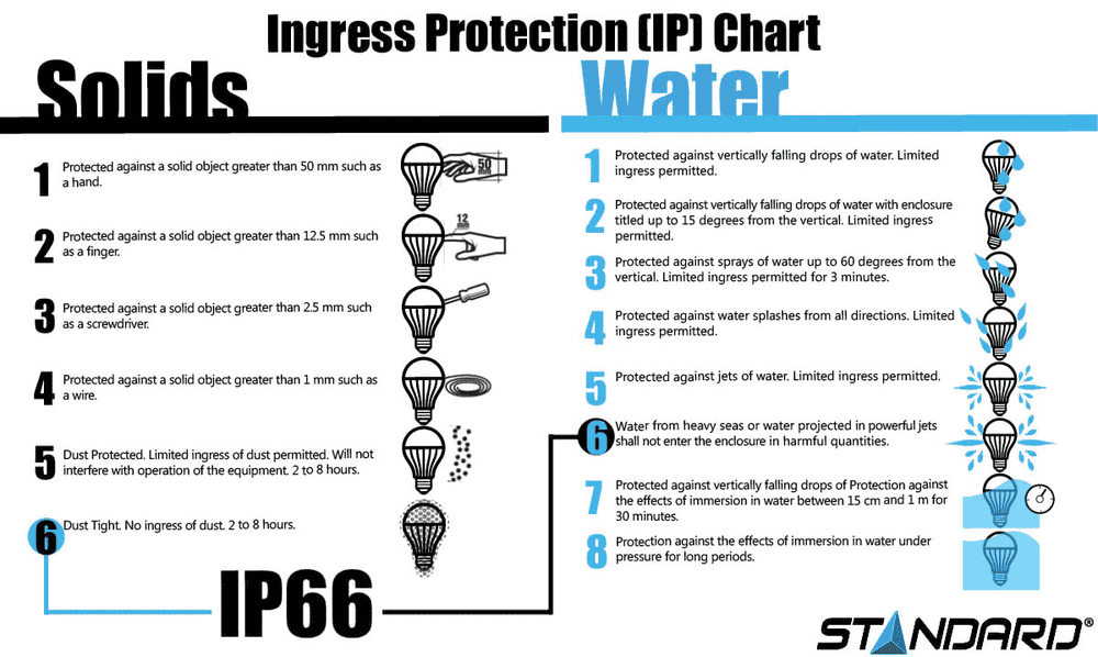

Do you need to weatherproof this first box? It's probably a good idea to start looking at semi-sealed plastic boxes with dust-proof external connectors. If you are really dissipating 54 Watts in this assembly, you may need a fan with filters or something to help cool it. Or if you have just one thing that is dissipating most of the power, then you might be able to go with a sealed metal box and use the metal box as a heat sink (like if the motor driver transistors are the main source of waste heat).
BTW, it's not too early for you to start learning about the industry standard IPxx ratings for various levels of enclosure protection against solid and liquid intrusion. The chart below does a pretty good introductory level job of describing the various ratings. A number of my company's products need to meet IP66 rating, which is non-trivial to achieve (especially if you have any hot components inside)...
https://www.standardpro.com/wp-content/uploads/2019/12/Infographics-Nov_IP-Chart_EN.jpg

@berkeman Thanks for the advice. We were thinking IP66 or 67 for the case. You're right to question my power consumption numbers. I misunderstood/made some mistakes in the way I calculated it. I can share methodology if these still look funky but @ the 12V line, I'm expecting a maximum of 2.023A or 24.27W for the systems power consumption.
This figure uses servo stall current, SBC startup power consumption(highest amount), the high end of capture card power consumption range, and the low end of regulator (USB-C and Buck) efficiency. My partner said the capture card and camera ran a little hot but not sure how much. I avoided using a linear voltage regulator(7805) for just that reason.

Update: powering the Servo via GPIO pins on Raspberry Pi is not a good idea. Looks like I may need another buck converter.
The stall current of servo is approx 660mA at 5V. The 5V rail is connected to USB input so It can(in theory) provide whatever the USB provides (approx 1A) minus board consumption which according to my research will be up to 850mA. Here is my reference source.
