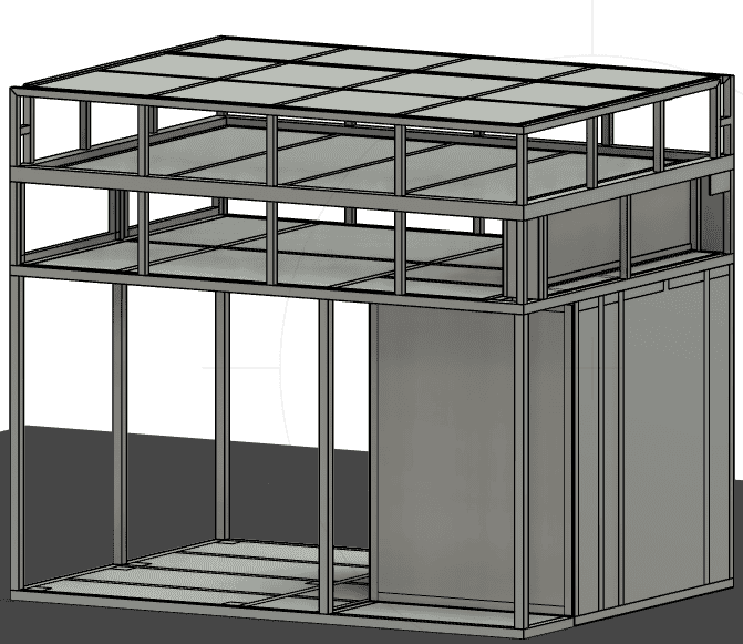

Referring to the attached, the bottom right is an electronics compartment. The external panels are 20GA steel powder coated yellow. There is 1-inch of R-6 foam board insulation on the inside of all external walls. The skid is exposed to ambient heat and direct sunlight when on site. If we replace the 20GA steel with aluminum panels, will this reduce the heat transfer into the compartment or is the powder coating & color the deciding factors?
How much power do the electronics use (worst case)? Where is the foam located?
Foam is on all six sides with the foil reflective side against the 20-gauge steel panels, so the compartment is encapsulated in the insulation and completely sealed. For the power consumption, we run the equipment on shore power right at 15A on 120VAC, which does not include the HVAC that is on a separate shore power circuit. The PLC uses PWM to manage the power load. As part of the overall heat load management, I am considering replacing the 20-gauge steel enclosure side panels with 18-gauge aluminum panels as well as using a lighter powder coating color. What I am unsure of is whether either or both of these modifications will make enough difference to warrant the changes.

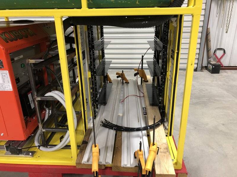

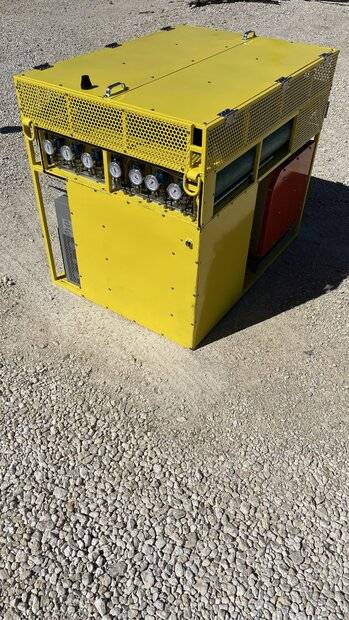

Here are a couple of photos to give you an idea of the compartment. The external photo shows the two main sides exposed to the sun and reflective heat from the gravel pad.
I have a call with a powder coating manufacturer tomorrow to see what they have to say about their colors and textures WRT reflectivity in the IR spectrum. Hopefully they will have some answers.
Most of the energy (heat) from the sun is in the visible not the IR. If you want to minimize solar heating add a mirrored shield with an air space behind on the outside sunny side. The box walls can be either Al or steel...it will matter little.
This turned into a post that is probably more than you wanted to know - but here goes.
At 1800 Watts dissipated inside that enclosure, much of the heat is from the electrical dissipation, about 6100BTU. Get rid of that R-6 insulation, you want that heat to escape thru the sheet metal, which is about R-1.
To get the problem in perspective, if the only cooling is conduction thru the enclosure, limiting to a 10°F temperature rise above ambient requires 610 sq.ft. of enclosure surface area, in the shade - 7 times that area if using the R-6. (estimates assume convection of still air)
Solar energy is about 95 Watts (300BTU) per sq.ft. (clear day, Sun overhead)
Being in contact with the enclosure, that foil effectively becomes part of the enclosure and serves no useful purpose. If you must have the insulation for sound deadening, space it from the enclosure, that way the foil reflective layer can radiate some of the solar heat back out.
Then as @hutchphd suggested, add that mirrored shield with an air space behind.
If the horizon is visible from the enclosure, you might want to tilt the mirror down a little to avoid blinding people around Sun rise & set.Cheers,
Tom
Thanks Tom and this is exactly the conversation for which I have been looking! In addition to the PLC, computer, modem, and 120VAC-24VDC power supply putting out heat, there is a heated head pump, a heated filter, and a heated valve. This train is connected with 1/4" stainless tubing with Swagelok fittings. All three devices maintain 375F and are insulated. The tubing connections are wrapped in felt insulation to maintain the same temperature. With all of the insulation, the heat does not immediately radiate into the compartment and some of it is expelled through an exhaust line. Once the PLC stops heating the equipment, it takes about 1.5 hours for the HVAC to cool the compartment down to ambient, depending on the ambient temperature at the time. Obviously this is because the heated devices are radiating through the insulation over that period of time. I had thought about removing the insulation, but wasn't sure if that would work considering the interior temperature is maintained at 76F, so wouldn't the higher ambient temperature heat the compartment?
