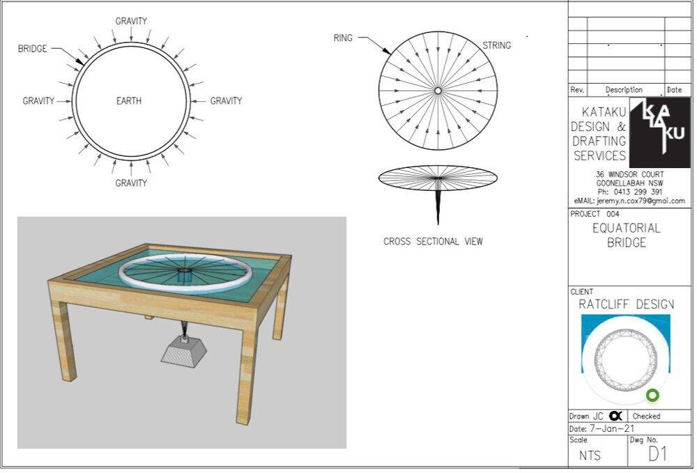

Hi, I’ve got a question.
it seems that engineers, structural mainly, don’t seem to understand how gravity works regarding an endless stationary (steel) ring/bridge around the equator.
Many if not all have said that such a ring would be modeled as two half circles pushing into each other. So the ring would need to be thousands of times stronger than the material...
I say, and many non-structural engineers agree, that the above assumption is wrong.
it is easily demonstrated with the following example...
Place a tube in a tray of water and attach strings through a funnel in the centre. Add equal self weigh of the tube and nothing will happen. Regular grade 350 steel will take almost 4,000 times it’s own weight.
One reply was that the ring “wouldn’t be floating on water anyway”... Another sent me the maths on how much weigh the tube would hold before it sank into the water... I had to explain that the water only represents lateral stability which is easily controlled and that the ring would be held in place with ground anchored cables. Hovering above the earth.
Because structural engineers are so knowledgeable about land bridges, is it possible that they cannot visualise how gravity would effect such a structure?
I have asked many to explain why they think that their model is right but they refuse to reply... Is this a common phenomenon/mind blockage amongst engineers?
Interested to hear your thoughts.
David
Here’s a link that pretty well confirms my analogy... surely they know what they’re talking about!

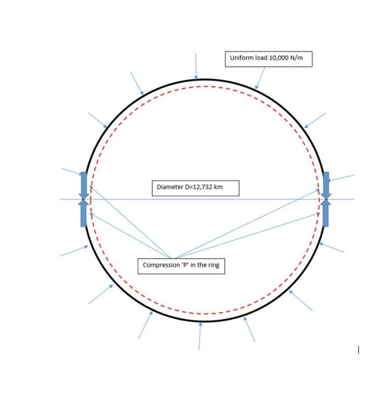

The engineers are correct. Let's do a simple calculation.
Imagine, for simplicity, the bridge is a footbridge and it is 1m wide and 1m deep and made of concrete.
Concrete weighs about 2,500 kg/m^3 so a 1 metre length of the bridge will weigh 2,500kg.
See the diagram below where the angles are exaggerated to show the effect.
The weight acts downwards and the compressive force P acts circumferentially.
Now the vertical components of the two circumferential compressive forces must be equal to the weight of the section so 2 x Pvert = 2,500kg, or Pvert = 1,250kg.
We now know Pvert - all we need to do is calculate P.
The angle theta to the Earth's centre is 1/6,366,000 radians or (1/6,366,000) x 2pi/360 degrees
Looking at the right we see that Pvert = P sin (theta/2) kg
So we have Pvert = 1,250kg = P sin (theta/2) kg
So P = 1,250/sin(theta/2) kg
Sin(theta/2) is sin(0.5/6,366,000) = 0.0000000789 which is very small.
So P = 1,250 / 0.0000000789 kg = 15,840,000,000 kg, or 15.8 million tonnes, which is very big.
Calculate the stress on the face. The face is 1m x 1m so it is 15,840,000,000 kg/m^2.
The maximum stress concrete can withstand is about 16,000 lb/in^2 which is about 16,000 x 39.37 x 39.37 / 2.2 kg/m^2, or 11,272,704 kg/m^2, or 11 thousand tonnes/m^2.
So, concrete can withstand 11 thousand tonnes per square metre and you are stressing it at 16 million tonnes per square metre.
It breaks long before the moon has any chance to affect things.
You can save yourself a lot of hard work by realising this problem is identical to a pressure vessel where every student remembers the formula Stress in wall = PD/2t (Pressure x Diameter/(2 x wall thickness)). Just plug in the numbers.
Engineers would have used this formula to calculate, in their heads, why no known material can build such a bridge - it doesn't even need pencil and paper.
So, in answer to your question: Do structural engineers understand how gravity works? The answer is yes they do ... even if you don't!
